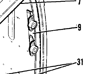

While I was working at Cessna, back in the dark ages,
the single engine cowls were modified to mount onto
brackets riveted to the firewall. These brackets were
fitted with rubber shock mounts with Dzuse sockets.
The idea was to 'float' the cowl off the fuselage structure
for reduction of engine noise in the cabin.

Prior to the floating cowl, a contiguous cowl mounting
flange extended forward off the firewall.
After the floating cowl upgrade, fielded aircraft began
experiencing contactor failures due to moisture ingress.
