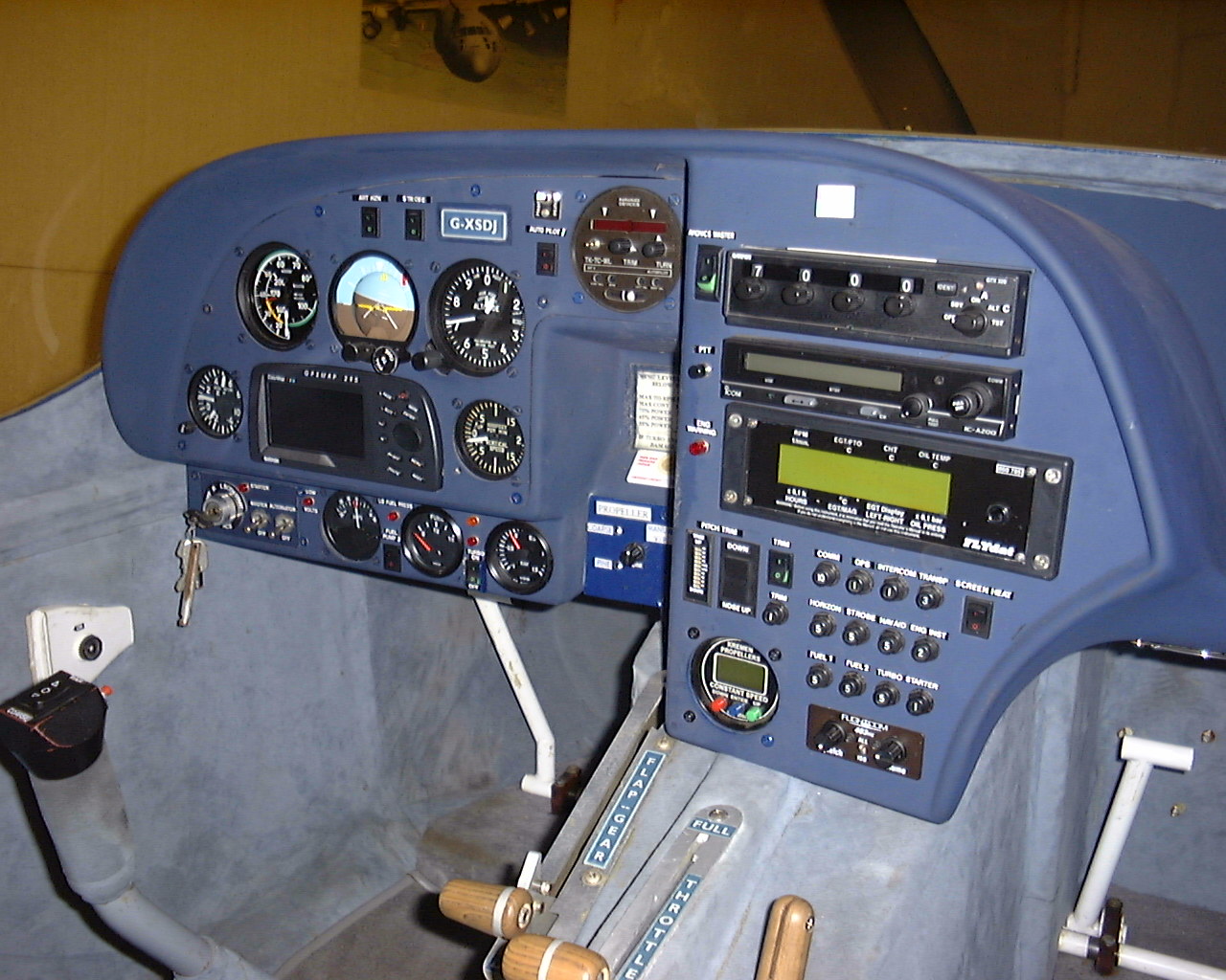

Glenn, I did my plane with2mm foam in the front half, covered with Alcantara - all attached with spray on rubber glue. The panel and the rear half  (seat back backwards) were spray painted with durable matt paint in matching colour. The foam was aimed at a bit of noise reduction and thermal insulation. It has all worked well and worn very well. Alcantara is a sort of synthetic, washable suede, which the guy who sold it to me informed me was fitted to Maserati dashboards! I avoided heavy upholstery and went for removable (hence adjustable) cushions, which were somewhat modified matching coloured cushions from an old Citroen car found in a scrapyard. The same car provided the carpets, which I had nicely edged by an upholsterer. Picture attached.
Regards, David Joyce, G-XSDJ
