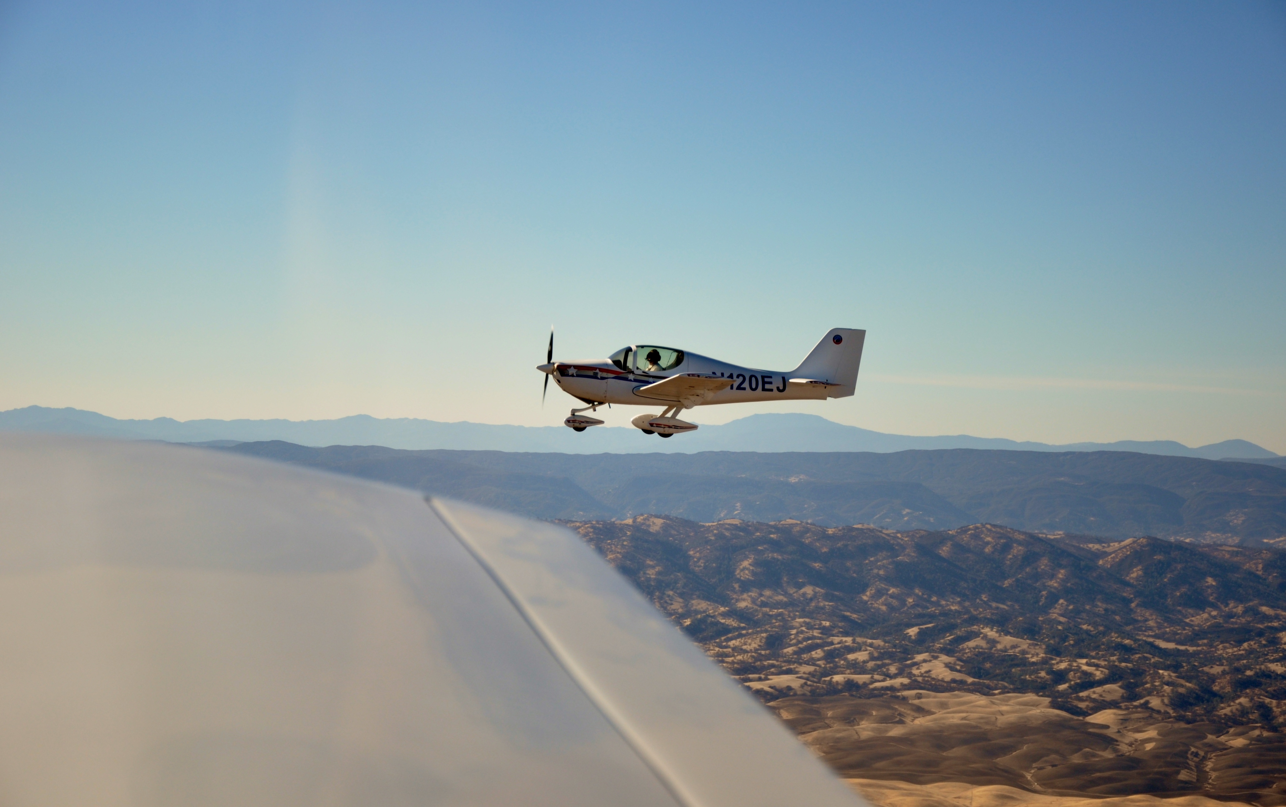

Took an early morning flight in N120EJ to have a new connector put on my VOR cable. Once the new connector and a check with the ground base VOR headed up to 10000 feet. It was beautiful here in northern California. I could see to the fog shrouded San Francisco Bay. Over hundred miles away. Fresh oil and filter, good compression check I'm headed for KOSH on Friday morning. Might make it on Saturday or Sunday. According to My iPad it's right at 13.5 hours and 71 gallons of fuel. I'll be following I-80 most of the way through the mountains. Once I reach Rawlings, WY. It's down hill to KOSH. Looking forward to see all the Europa's and their owners.
