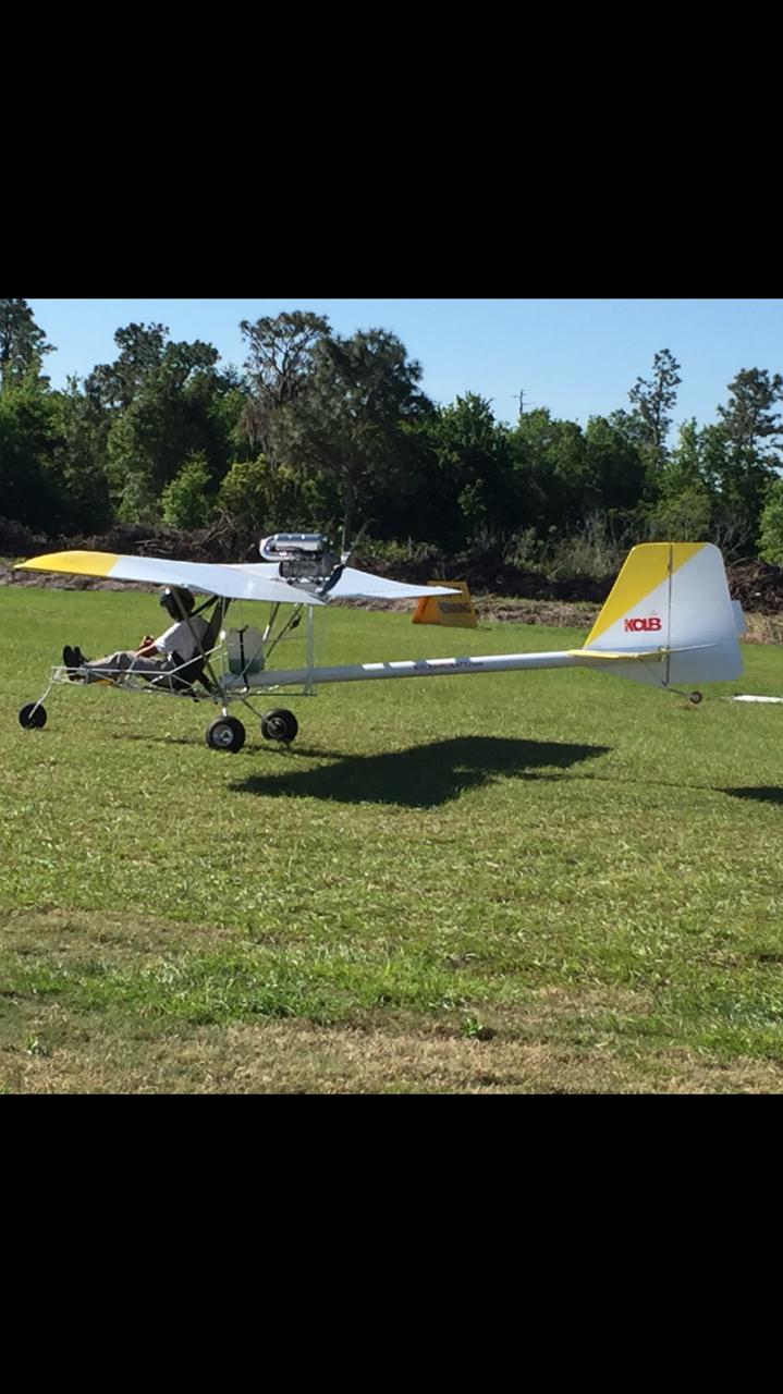

I was speaking to Brian Melborne yesterday, and expressed my wishes as to wanting a Bush Kolb. I told him I want STOL as top priority. Rotax 447 or 503. I told him top speed is not important, but slow flying Characteristics are. I just like to boat around, low and slow. Anyhow, he said he has been flying a Firefly with extended wings, and the wing is now undercambered. He said he weighs about 205 and with him in it, he said, and I quote,
"It stalls in the teens". I told him I am very interested in this and he sent me a picture of it from when he was at Sun n Fun. It was set up as a tricycle gear which I would not want, but he said making it a tail dragger is not a problem. I realize this would not be 103 compliant, but I would then just go sport pilot.
 Filesize:  1009.83 KB
 Viewed:  23739 Time(s)
victorbravo(at)sbcglobal.
PostPosted: Thu Jul 07, 2016 12:28 pm    Post subject: Extended wing Firefly Reply with quote
Wow, that's cool !
Did he say that the "undercamber" is a new undercambered wing rib, or is it just drooped ailerons on a standard Kolb wing ?
Did they have to enlarge the tail to compensate for the increased nose-down pitching moment form the new airfoil?
Looks really interesting Smile
Bill Berle
On Thu, 7/7/16, mikemac <mmacpherson(at)homesale.com> wrote:
Subject: Extended wing Firefly
Date: Thursday, July 7, 2016, 1:02 PM
"mikemac" <mmacpherson(at)homesale.com>

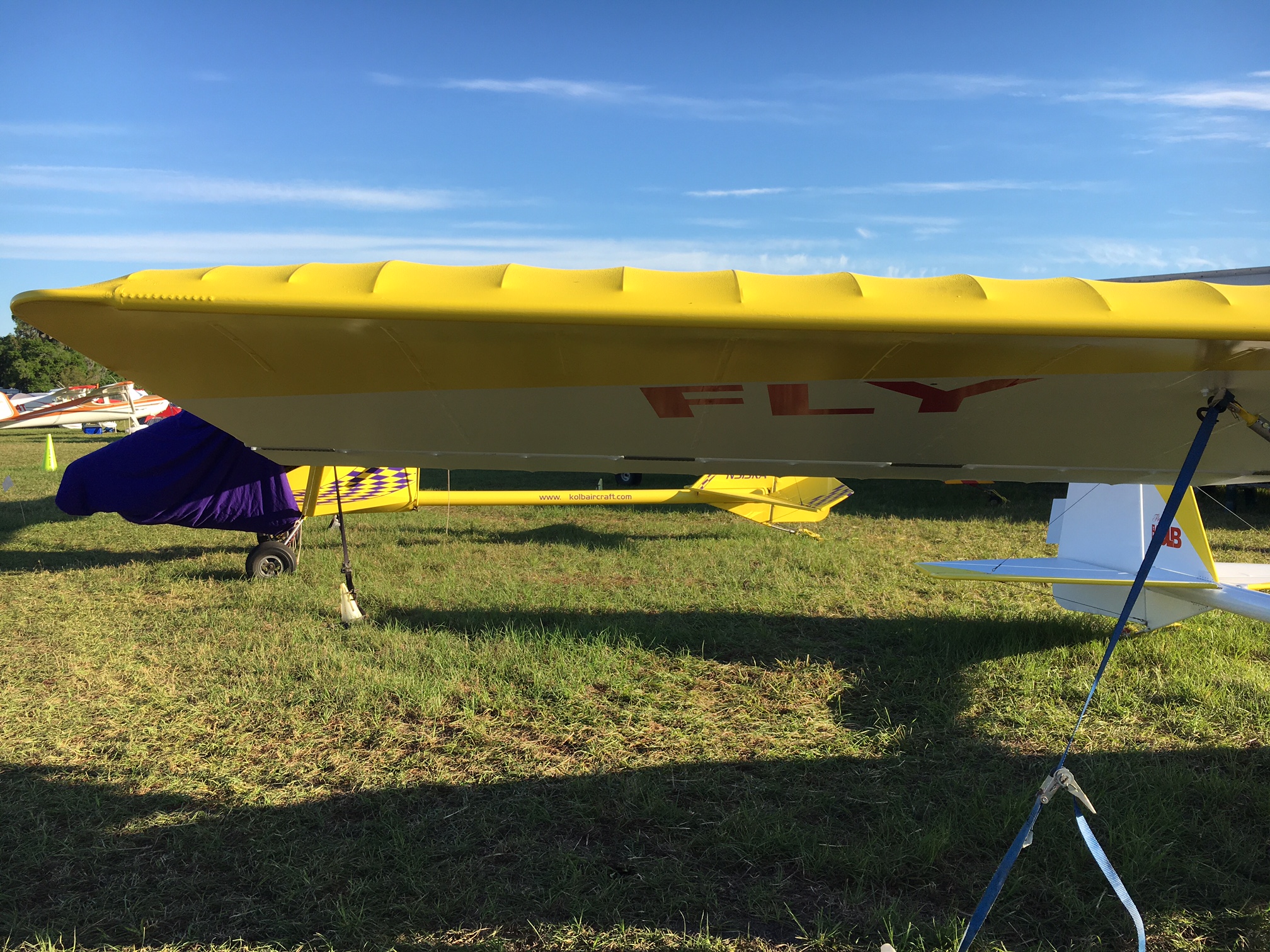

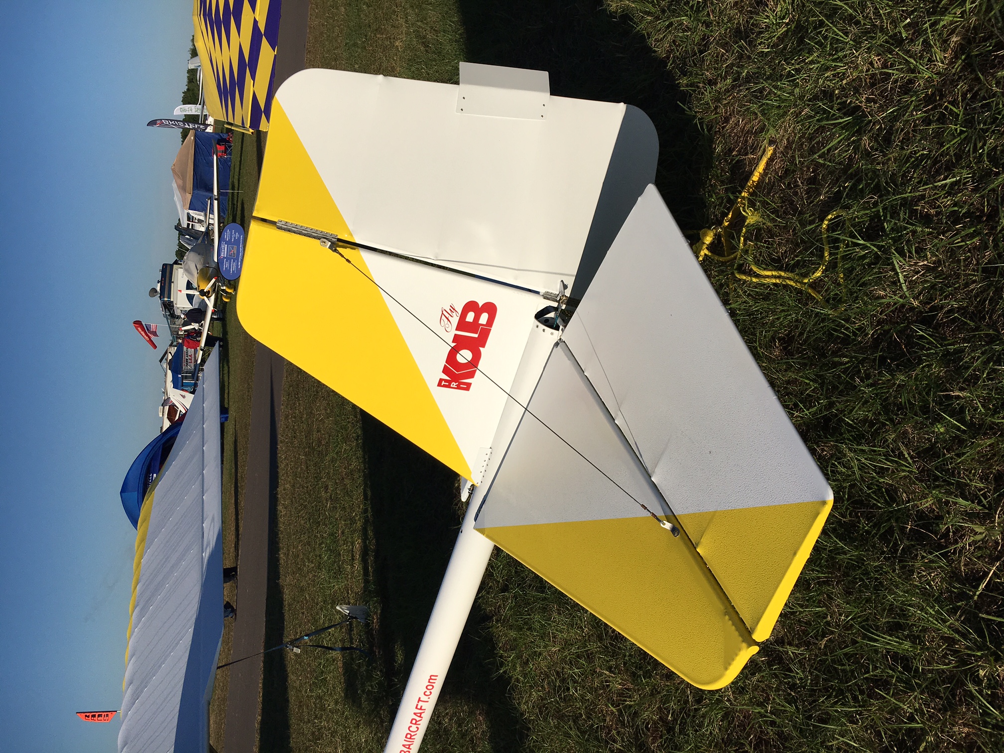

Here are some pics of the Tri-Fly. If anyone want pics, please email me at mmacpherson(at)homesale.com I am having problems trying to load the ones that Kolb sent me.
Under Camber

PostPosted: Sat Jul 23, 2016 9:38 am    Post subject: Extended wing Firefly Reply with quote
oops only one of them came through. Is this one yours? I looked on the website and could not find any info about this one. I find it tempting and possibly the perfect vehicle to hunt Coyotes with. Smile

PostPosted: Sat Jul 23, 2016 9:43 am    Post subject: Re: Extended wing Firefly Reply with quote
I tried to load two more pics but when they come through the system rotates them for some reason.
