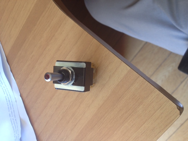

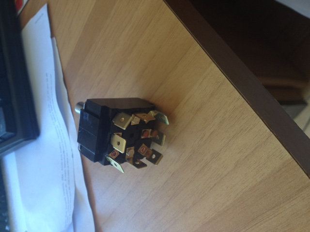

This switch
is model LT-2561-601-012 from Carling Technologies, which is a DPDT switch with illuminated lever tip.
I know that the 2 sets of 3 contacts on each side are the DPDT contacts, so no doubt about their wiring.
Now about the other 2 middle contacts, which are for the tip illumination, how are they wired?
Carlos

trigo(at)mail.telepac.pt
PostPosted: Sat Jul 02, 2016 7:39 am    Post subject: Switch wiring Reply with quote
Guys
The switch in the attached images is model LT-2561-601-012 from Carling
I know that the 2 sets of contacts on each side are the DPDT contacts, so no
Now about the other 2 middle contacts, which are for the LED tip
Carlos

I can only conceive of one way to connect it: as you said, the terminals down each side are the switch contacts, with the center terminal common in each circuit. +12V is connected to the common terminals and switched to the terminals on the corners.
My guess is that +12V is also switched to the lamp internally, and the upper and lower middle terminals would be connected to ground for illumination in each toggle position. You would only ground the side you want to light up, or both if you want illumination in both ON positions.
This would allow you to control the switch illumination by grounding it through another switch elsewhere; say, a limit switch. If the switch were used to control flaps, for example, the toggle would be lit while flaps are moving, and extinguish when they reach the limit switch, breaking the bulb's ground path.
You may find that the lamp operates from only one of the +12V common terminals but not the other, or that each toggle position illuminates from a different common terminal. This would be done to maintain separation between the two SPDT circuits that make up the DPDT switch.
A quick bench test would confirm or refute my hypothesis. If you don't have a bench power supply handy, a 9V battery should suffice to light the toggle's bulb. Or even an ohmmeter set to test continuity should work through an incandescent bulb.

The two extra terminals could power the lamp independent of the switch mechanism. Then it would be up to the installer to add jumper wires. The spec sheet says, Independent lamp is Standard, dependent lamp is available. Other than having an internal lamp, the switch could operate exactly like any other DPDT switch. For switching higher voltages, a separate 12 volt supply would be needed for the lamp. The lamp might be located in a fixed position and shines through fiber optics in the actuator lever.
This is all guessing on my part.
I like Eric's ohmmeter or 9 volt battery suggestion.

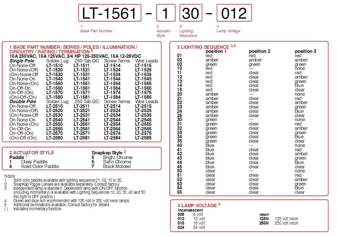

Here's the carling data sheet on that series
of switches.
http://tinyurl.com/jda6zop
Looking at an exerpt we see
[img]cid:7.1.0.9.0.20160702145139.055eaeb0(at)aeroelectric.com.0[/img]
Your LT2561 is two pole, three position on-off-on
with .25" quick connects, satin chrome handle,
red display in all three positions and a 12 volt
incandescent lamp (so you don't have to worry about
polarity).
 Filesize:  538 KB

Well, I had to ask exactly because the Carling documents don't have any information about the contacts, not even a wiring schematic, as it is usual.
Thanks Werner, Eric and Bob; Now I know that the middle contacts are very simply the 2 lamp contacts.
Nice! It is already wired...
Carlos
