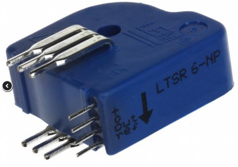

Current Sensor basic question
donjohnston
Joined: 13 Dec 2009
Posts: 232
PostPosted: Sat Jul 09, 2016 11:34 am    Post subject: Current Sensor basic question Reply with quote
I'm using the 50a hall effect sensor which came with my Grand Rapids EIS 6000. But the current numbers don't jibe with the VPX. It's not a huge difference, but enough that I don't like it.
I've talked with GRT and verified the offset and scale factor configuration but it's still not right.
While searching to see if anyone else was having this issue I ran across an aftermarket sensor.
High accuracy current sensor
http://www.crazedpilot.com/high-accuracy-current-sensor-for-5v-input-7-30v-supply-engine-monitor-systems-dynon-mgl-grand-rapids-garmin-and-more-ems-efis-systems/
Interestingly, it looks just like the GRT sensor.
I contacted them to make sure it would work with the EIS6000 and if it came with the offset and scale factor values that needed to be configured on the EIS. They said yes and that the correct values were based on the wire size being used. There is nothing in the GRT documentation about the wire size having an effect on the offset and scale factor settings.
Is it true that the size of the wire effects the reading of a hall effect sensor?

PostPosted: Sat Jul 09, 2016 12:43 pm    Post subject: Current Sensor basic question Reply with quote
In general that is 100% correct, but this sensor doesn’t appear to have a split ring to concentrate the magnetic field into a Hall sensor.
When you’re not collecting the whole field, geometry has a large effect on field strength.
I’m curious how this sensor works or if they expect some sort of calibration step after installation.

PostPosted: Sat Jul 09, 2016 12:46 pm    Post subject: Current Sensor basic question Reply with quote
It appears from the photograph that it's sensing the magnetic field at only one or two points; The field decays in strength with distance away from the conductor, and measured at the surface surface a larger conductor has a smaller field than a small conductor carrying the same current (because of the 1/r rule) so I would expect the size of the conductor to make a difference.
If the current sensor were a transformer (which effectively integrates the field strength around a closed loop surrounding the conductor) then no, the size of the conductor wouldn't make a difference; but this doesn't appear to be such a thing. Of course a transformer wouldn't be able to detect a DC current so you'd have to be doing something very smart like integrating the transformer output which would be expensive, and probably inaccurate.

PostPosted: Sat Jul 09, 2016 1:00 pm    Post subject: Current Sensor basic question Reply with quote
Bill
I certainly agree for what I'd call a common hall effect transformer
with the sensor in a gap of a magnetic torus and the wire through the
center hole but the pic that came up when I clicked on Don's link just
appeared to be hall sensors strapped directly on both the sides of the
wire. I would expect such an arrangement to be affected by wire diameter?

I use a closed loop, gapped core sensors in
my instrumentation packages. One of my favorites
is this critter
http://tinyurl.com/zxsdyj4
[img]cid:.0[/img]
It's core function is a plus-minus 6A sensor
but easy to 'jeep' into fractional multiples and
sub multiples of 6A. Of course, it's designed to
mount on an ECB but I've converted dozens of them
to remotely installed sensors at the end of pendant
cables.
These are gapped-core, closed-loop sensors with
great linearity and calibration numbers. They
too could probably be adapted to the popular
displays. The price sure is right.
