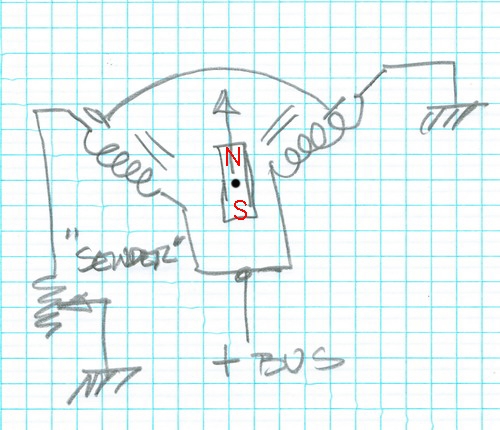

I believe the vast majority of OEM and after market automotive
instruments are of the 'moving magnet' variety. A
magnet is mounted to a shaft such that it lies within
the effects of two stationary, electromagnets. Energizing
electromagnet 1 moves a pointer to one end of the
scale, energizing EM2 moves it toward the other end
of the scale.
[img]cid:.0[/img]
The position of the pointer is the vector sum of the
fields generated by the two electromagnets. Hence,
the pointer depicts some ratio of the two energizing
currents. The cool thing about this technique is
simplicity of manufacture. The pointer doesn't need
to have return springs. The magnet can be immersed in
a damping fluid that causes it to integrate small
fluctuations in the measured current thus giving
a steady reading when the signal (like fuel sloshing
in a tank) is wiggly. The positioning forces are
large meaning that the pointer shaft need not
be supported on low-friction bearings . . . often
simply stuck through a hole in sheet metal or
plastic.

This means that the instrument reading this variable
resistance is designed to indicate 0 psi when current
thru 10 ohms is impressed on the left-most coil and
allowing the pointer to move toward the right-most
coil as the resistance goes up to 180 ohms with
increasing pressure. My new sender isn't the stock
GMC part, so the instrument that came with the sender
will have to be installed also.
The instructions with this, and most after-market
instruments will show three terminals on the
back . . . one of which goes to 14v bus, one to
ground, the other to the 'sender' which is grounded
through its fitting to engine's crankcase.
These two-coil instruments are generally limited to a
small stroke scale . . . on the order of 90 degrees
maximum and their accuracy is generally on the order
of 5 to 10 percent of reading. Multi coil insturments
can offer longer arcs . . . like speedometers. Further,
when driven by software in ECUs, they can be much more
accurate . . . perhaps 1-2 percent.
In the case of the oil pressure instrument, the 'sender'
(transducer) and instrument must be matched to each
other. They consume very lo currents from the bus . . .
on the order of 50 milliamps.
