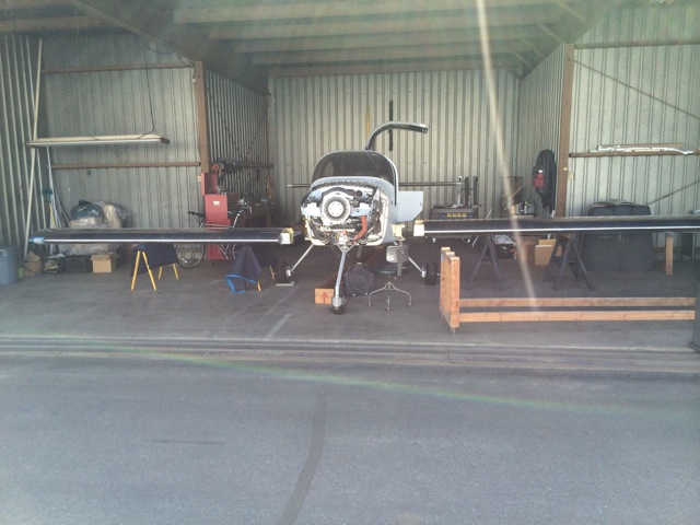

Short answer: two people, doesn’t tip over, expect the bolts to be very tight (for trial fit use regular bolts). We balanced the wing on a support so that one guy on the end could easily lift or lower the tip, while the other guided bolts in. You’ll get lots of ideas about final bolts on dry ice to easier insert, etc. We found that on ours, there was a tiny misalignment of the outer layer of the main spar that prevented the final bolts going in smoothly. Not really a big deal – have at it!

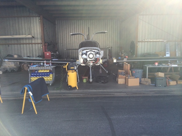

Other than getting help putting the wings up on to saw horses I was able to do it myself. Just take your time and be sure to make and use the drift pins that are mentioned in the plans.

I like doing it with 4 people, one to hold the wingtip, one on the trailing edge, one on the leading edge and one to put the bolts in. The guy on the wingtip will need to move up, down, forward and aft to get the holes lined up. The guy on he trailing edge will need to spread the rear spar attach points to get the rear spar in (don't pin the rear spar until the main spar bolts are in). It will sit on the wheels with one wing on. No support needed as long as there is no fuel in it.
If you can find some old bolts the right size for the larger or smaller main holes, cut off the head and make a bullet out of it and drive that through and follow it with the bolt with the shaft greased.
Be careful with the outboard bolts where they can hit the fuel tank fittings.
Two bolts (one top and one bottom) will hold the wing so you can move to the other side and cut your helpers loose.

I used saw horses that I could move back and forth to align. Moveable cart might have been easier. I had misalignment of spar web, thanks to quick build, I guess. Had to talk to Vans on how to correct without affecting the hole in main spar. Used ordinary bolts with threads ground off for pilot alignment. Used plenty of LPS 3 to make things go together. Installed the close tolerance bolts after soak in dry ice, and lube. Still snug.
