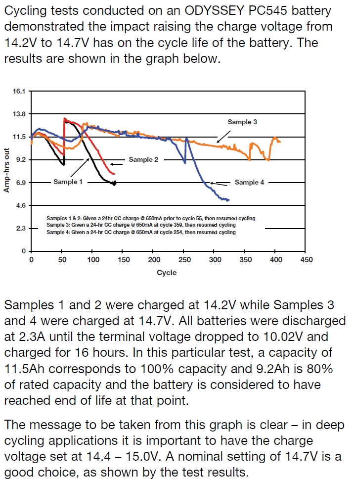

The sealed vented lead-acid (SLVA) likes to be
charged more aggressively . . . excerpts from
the Hawker data says:
[img]cid:.0[/img][/b]
This fact drives the B&C policy decision to factory
set their regulators to 14.6 volts.
<ea42f08.jpg>

Finally, once the stock regulator is working, you may want
to consider a more modern ADJUSTABLE device that can be
set to accommodate the special needs of SVLA batteries.
