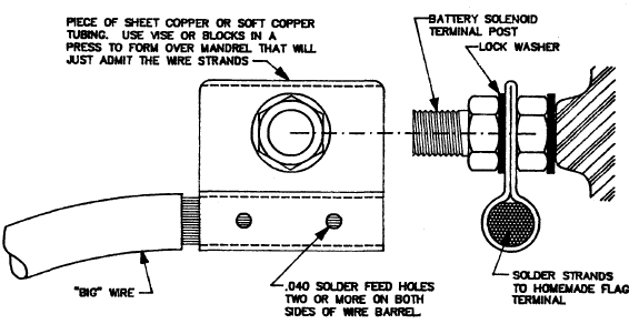

[img]cid:7.1.0.9.0.20160606151319.0617aa68(at)aeroelectric.com.0[/img]
Also consider fabricating your own 'flag' terminals
to be soldered on as described in Ch9 of the
'Connection. If you're really handy with the metal
forming, you can make right and left hand flags
that would stack back-to-back so that two
offset fat wires in addition to a third, straight-on
conductor could go onto the same terminal with
the both offset wires on the same side.
Consider 3/4" hard-copper couplers as raw material
for the terminals . . . pick a drill bit for a mandrel
that fits the proposed fat wires.
