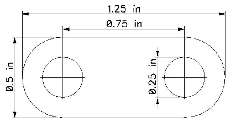

I had another idea. Fabricate a copper, brass or aluminum tab similar to the attached image, allowing two side-by-side wires to head off in the same direction. One hole goes over the stud you're attaching to, along with the heavy wire's lug. The two lighter wires' lugs go back-to-back, bolted to the other hole. Size the tab for your hardware and available space. Use star washers keep things from moving around.
