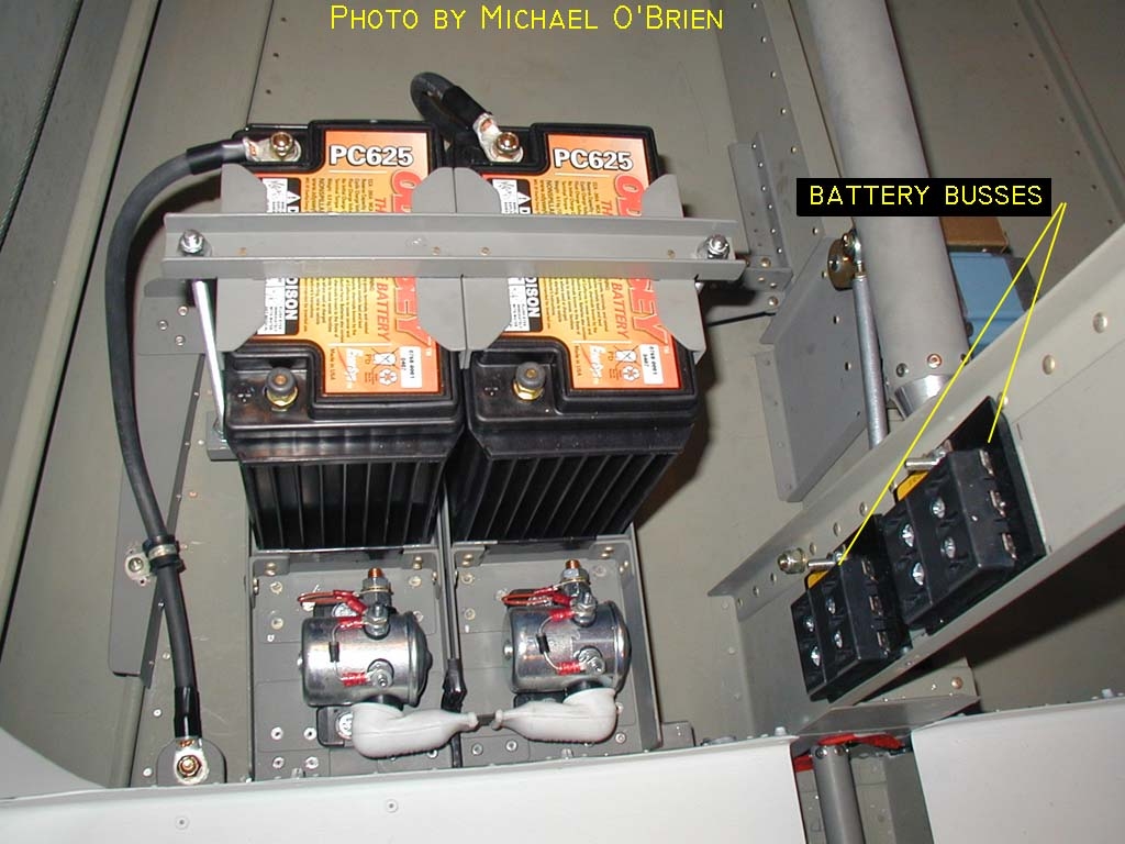

AGM batteries do not need 'boxes' . . . they will
not leak even if you drive a nail into them and
pull it out. Just strap them down with materials
that equal or exceed the legacy 10g crash retention
design goal. That means for 15 pounds of SVLA battery,
you need 150 pounds of tear-out resistance. Here's
a dual, 12v battery installation that most likely
meets that goal. Set the batteries in a shallow
tray and strap them down.
[img]cid:.0[/img]

Heads-up; not universally true. Commonly available agm quit starting my rv4 after about a year of use.  Pulled top cowl & found a pinhole in side of case, & acid stain on the firewall 'shelf'.   Obvious acid trail from pinhole. Furtunately, it didn't eat through the stainless firewall.
I still use open hold downs like the pic, but a rubber 'tray liner' now seems advisable.
