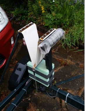

PostPosted: Sat Jun 11, 2016 7:54 pm    Post subject: Wings for monowheel trailer stability Reply with quote
William…I shared your concerns…and I was particularly concerned about the stability of the fuselage when removing and installing the wings…the attached photos show the FG covered foam blocks I fabricated to do so…all in all, a small and easy job…I made the blocks to be removable, thinking they would be problematic when rolling the plane on and off the trailer, however, I’ve found that raising the tail creates the required clearance. While in transit, I use a rachet strap to keep the fuselage from moving.
Fred
[img]cid:AC730F0B-9A87-4F6E-BB17-F88614CE26A7(at)Home[/img]
[img]cid:C1BDB637-7683-45F6-8E7A-92E3E175E35C(at)Home[/img]

clivesutton
Joined: 23 Jan 2013
Posts: 187
Location: KENILWORTH
PostPosted: Sun Jun 12, 2016 1:53 am    Post subject: Re: Wings for monowheel trailer stability Reply with quote
Hello William,
I was also a bit concerned about the roll axis stability of my in-build mono in its trailer. My solution shown in the attached pic - a piece of original mono classic fuel filler hose bolted through to the top of the sling arm and wrapped in peel ply to stop the black rubber marking the fuselage.
Once loaded, it lightly touches the fuselage side in the vicinity of the forward lift pin mounting area and helps to keep it upright as the fuselage moves side to side.
The blue foam blocks under the slings are to counter my paranoia about them breaking in transit - which could do all sorts of expensive damage to the wing pin sockets glued into the wing spar if they were to be twisted/rotated against the trailer spar location bolt . . .
Clive

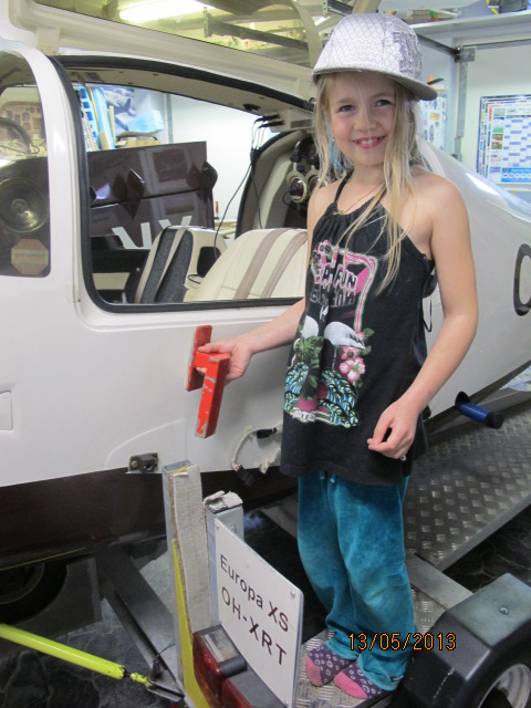

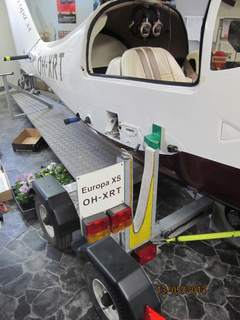

PostPosted: Sun Jun 12, 2016 7:42 am    Post subject: Wings for monowheel trailer stability Reply with quote
Hello William,
this simple solution has worked for me nicely years.
See attached pics.
Raimo OH-XRT
allekirjoitus
(info(at)rwm.fi)
11.6.2016, 16:05, William Bliss kirjoitti:
--> Europa-List message posted by: William Bliss <william(at)wbliss.co.uk> (william(at)wbliss.co.uk)
Hello all - Advice/experience please
I am planning on using cut down wings for preventing the fuselage rocking from side to side on the monowheel trailer.
I would get a pair of u/s wings, cut them off just outboard of the inner rib and make attachment points for a strap (or elastic bungee chord) to go down and attach to the trailer frame. These short stubby wings would attach to the fuselage in the same way as the flying wings attach.
Does this seem like a good idea? My slight concern is that the forces on the fusalage attachment points with road use may be greater than the forces they were designed for in flight. I would have thought this method has been considered before.
William Bliss G-WUFF
 Filesize:  137.46 KB
 Viewed:  9086 Time(s)
 Filesize:  134.84 KB
