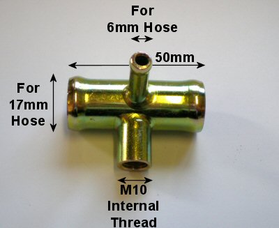

PostPosted: Mon May 16, 2016 1:15 pm    Post subject: Re: coolant choce and temperature monitoring questions Reply with quote
I used the Skydrive coolant temp kit, repositioning one of the 2 fitted CHT senders for use in the M10 threaded tube. The CHT sockets on my 912S are blind, so I could remove one without creating a leak - check yours, or just buy an additional sender for use in the coolant kit!
I have the carb heat kit, so needed the Adapter 3 (sort of double T piece - see picture) to take off both the carb heat and the temp probe.
http://www.skydrive.co.uk/products.asp?cat=67
It makes sense when you see the parts. Holler if it's not clear, although Mark (Mick?) at Skydrive is v helpful and will talk you through the options.
HTH
Paul - thanks, that is very helpful. I have the Skydrive carb heat kit too. I was trying to figure out how to monitor a 3rd temp sensor as my MGL instrument only has 2 NTC inputs, but I guess the answer might be to monitor the coolant and only the higher of the 2 CHTs.
