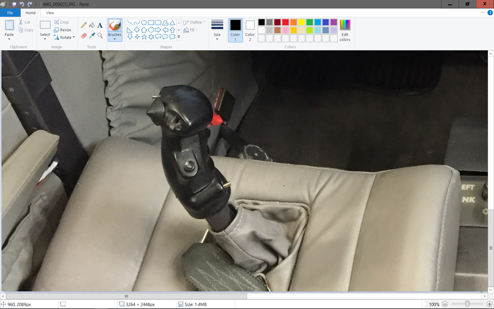

The other big wiring project I have is to connect the starter wire to the momentary contact switch is at the base of the infinity grip.
Someone said that I should use a diode and somebody else said that I should incorporate a relay into the system however the manufacturer said that the switch he uses is sufficient for a starter circuit.
Has anybody run sort of arrangement?
I have a Lycoming IO - 540 engine with a skytec starter motor.
THANKS AGAIN!!!
Bill Hunter

Better yet . . . don't do that. Probably a million
airplanes have been produced were the starter controls
were NOT on the stick . . . or anywhere else that
could be inadvertently operated . . .that issue
has never bubbled up as a human-factors 'problem'
to be fixed.
But more importantly, the FURTHER your airplane
departs from historic configurations, the greater
the risk for bad results from common assumptions.

Hmmm…good advice.  I did think the idea was a bit odd.  Better go back to the old push button…I might could use that button for another purpose…what do you think about using it for the ejection seat or drag chute features I am incorporating…what could possibly go wrong?!?!?
THANKS Bob and All for your kind feedback/suggestions!!!

I have an infinity stick as well. And never, ever considered putting the starter switch on the stick. I have assigned every switch on the stick to be only something that I would use while the aircraft is in motion to reduce the number of times I would have to remove my hand from the stick.
Here's my list:
PTT
Com radio swap
transponder ident
EFIS page flip
AP Engage
Trim
Starter, fuel pump, etc., are typically used once from startup to shutdown. In my book, that makes them impractical for the stick.

Ditto on Infinity. Here is my set-up
PTT
Coolie hat aileron/elevator trim
Flaps (momentary down, hard up to dump flaps with one motion)
EFIS page flip
AP Engage
Intercom/radio re-play (the radio automatically records)

I pretty much have the same switch assignment on my Aero Grip.
I hate having a switch installed in the airplane that does not do something... now that I eliminated the starter feature perhaps I could assign that switch to something already installed in the airplane like the taxi light, seat vibratory massage, satcom internet, or the disco ball motor... or... I guess I will have to dream up some new feature to add to the airplane so that the switch can actually do something.
THANKS AGAIN!!!

The HX series have a number of "pages". PFD, Engine, Map, etc. There is a "page flip" function where pressing a switch will cause the page to toggle between PFD and Map screen.
So while you're flying along, hit the "page" button on the stick and the screen changes to a full screen map. Hit the button again, and it goes back to the PFD.

Some years ago a homebuilder installed a flap button on top of his sticks on his MCR Sporster two seater.
One day his wife inadvertently hit the button with her map and retracted the flaps during takeoff...
He told us the recovery involved quite a bit of the "bag of luck" any pilot starts his flying life with.
