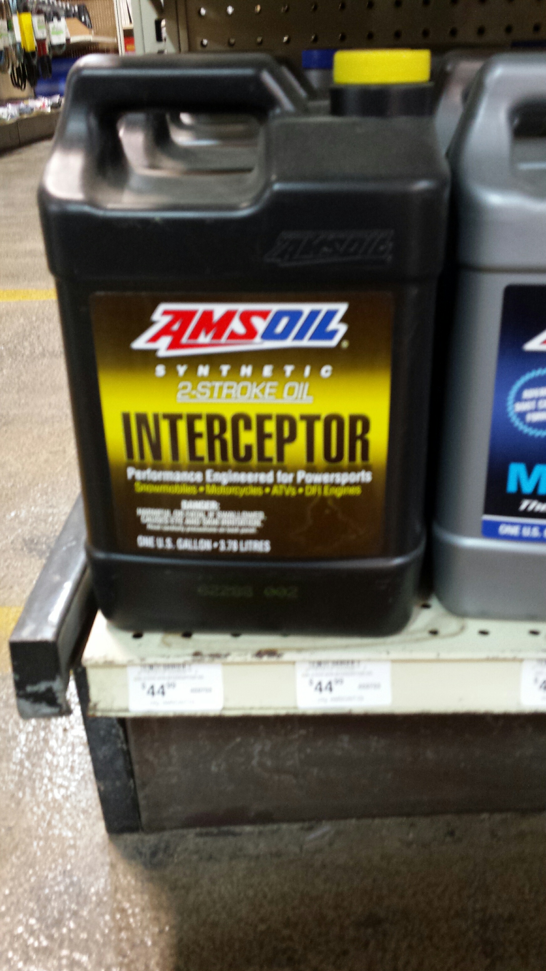

PostPosted: Mon May 23, 2016 9:43 pm    Post subject: what oil?? Reply with quote
Amsoil Interceptor best fuel milage and no dirty tail.
Sent from my Verizon Wireless 4G LTE smartphone
