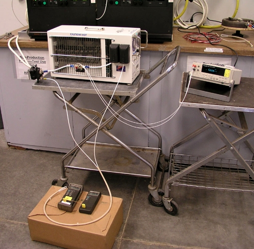

[img]cid:.0[/img]
Here's a bundle of wires that are insulated with the slicone/
fiberglas sleeving. The bundle has two 10AWG conductors that MIGHT
get loaded to 60A under some conditions. Out in the open
air, no sweat . . . or should I say no burn?
I set up a lab test for the boss to deduce the INCREASE in temperature
rise for having been bundled.
[img]cid:.1[/img]
Wire under the sleeve was 80 to 115C
hotter than the single strand in open air.

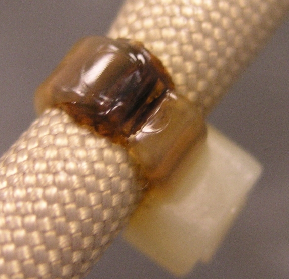

It was hot enough on the outside of the
fiberglas to discolor nylon tie-wraps
[img]cid:.2[/img]

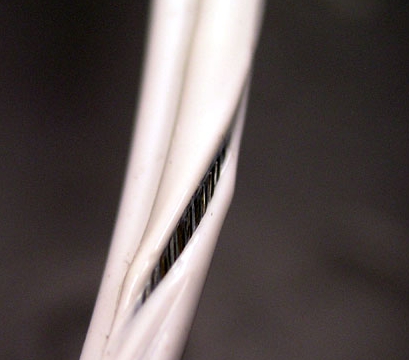

and the Tefzel insulation began to loose
its bond at the edges of the wrap
[img]cid:.3[/img]

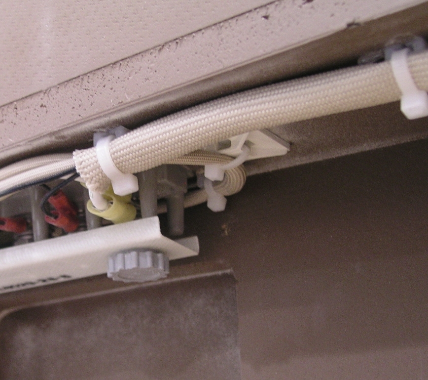

The copper inside was un-affected. As it turns
out, nobody ever installed ALL of the accessories
that would have put the airplane at risk. But it
was more trouble on the drawings to change the
optional equipment list. Only one drawing had
to be changed to upsize the wire. So a mandatory
service bulletin was issued against all aircraft
with that installation and the factory pushed the
upgrade costs off onto the field . . . to fix an
non-issue. Sigh . . .
