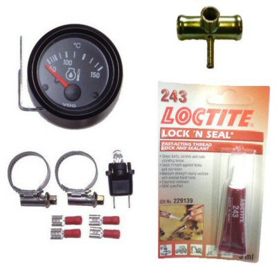

my Skydrive temp display only goes to 50 degrees max, do it is pretty useless except as an indicator for on/off.

I used the Skydrive coolant temp kit, repositioning one of the 2 fitted CHT senders for use in the M10 threaded tube. The CHT sockets on my 912S are blind, so I could remove one without creating a leak - check yours, or just buy an additional sender for use in the coolant kit!
I have the carb heat kit, so needed the Adapter 3 (sort of double T piece - see picture) to take off both the carb heat and the temp probe.
http://www.skydrive.co.uk/products.asp?cat=67
It makes sense when you see the parts. Holler if it's not clear, although Mark (Mick?) at Skydrive is v helpful and will talk you through the options.

PostPosted: Tue May 17, 2016 12:33 pm    Post subject: coolant choce and temperature monitoring questions Reply with quote
Sorry to hear that Karl.
I will connect mine to a Dynon Skyview EMS, so hope it will display all
temps!
Although the picture of the Skydrive shows the range as 50-150 °C, so maybe
you have a faulty gauge?
