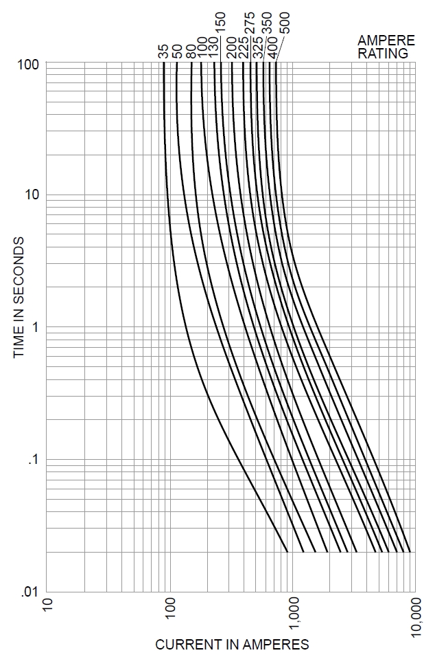

I have a 70 amp alternator and have a D180 with the dynon shunt. I also have a ANL-60 protecting the layout....should I replace that with a ANL-80?
No, 60A will be fine. As you can see below,
even an ANL50 would not be severely stressed by
a 70A alternator . . .
[img]cid:7.1.0.9.0.20160518152152.01ef2328(at)aeroelectric.com.0[/img]
 Filesize:  285.31 KB
 Viewed:  4576 Time(s)
