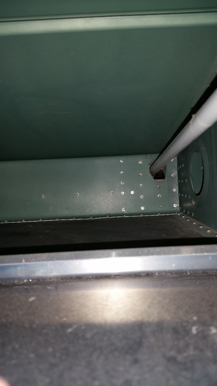

philperry9
Joined: 23 Nov 2011
Posts: 381
PostPosted: Tue May 10, 2016 11:00 am    Post subject: Service Bulletin Reply with quote

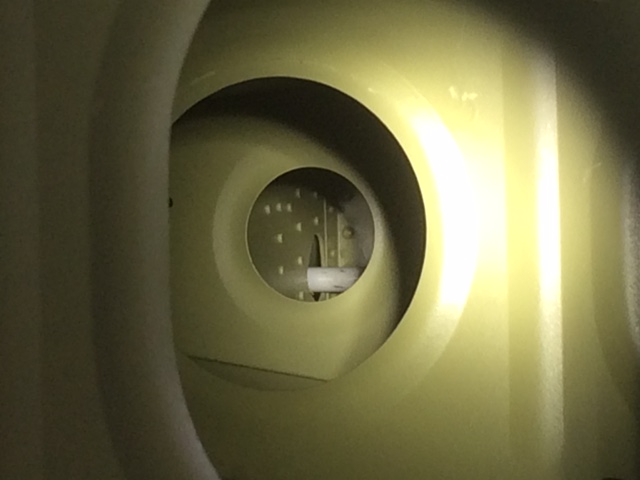

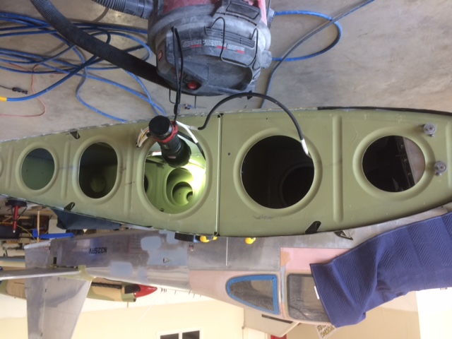

I have my wingtips off trying to get them to fit better. (Arg!)
But noticed that with the tips off, you have a straight line of sight to the backside of the bracket. With a long endoscope or borescope, you could get a good look at the backside.
Here's some photos...
Length from the outboard edge to the bracket is 56 inches. So a scope with that length of reach or more would be helpful.
Phil
[img]cid:389B057F-B1B2-4624-92E4-3C80D5153CAC[/img]

EdKranz
Joined: 29 Dec 2010
Posts: 132
Location: Hastings, MN
PostPosted: Tue May 10, 2016 11:37 am    Post subject: Service Bulletin Reply with quote
I don't think that's the side that's hard to inspect. I believe it's the aft side of the spar, under the gar fairing, that requires the aileron to be removed and gap fairing to be trimmed.
On Tue, May 10, 2016 at 1:59 PM, Phillip Perry <philperry9(at)gmail.com (philperry9(at)gmail.com)> wrote:

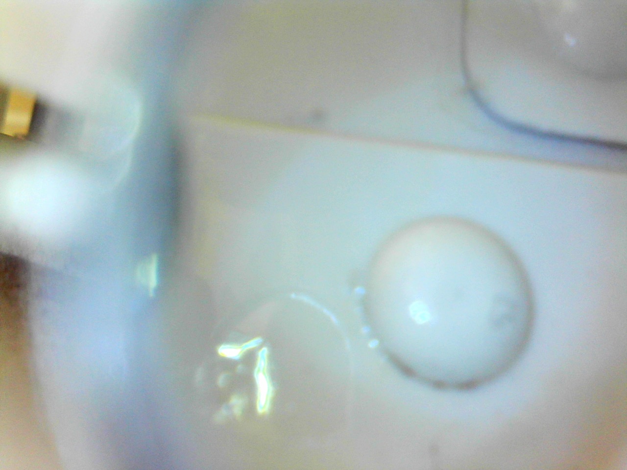

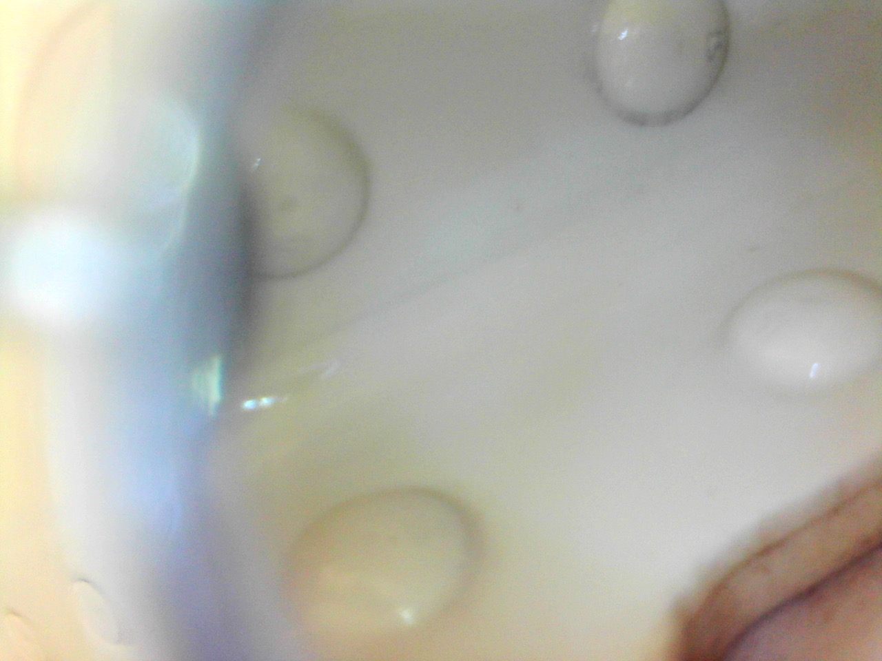

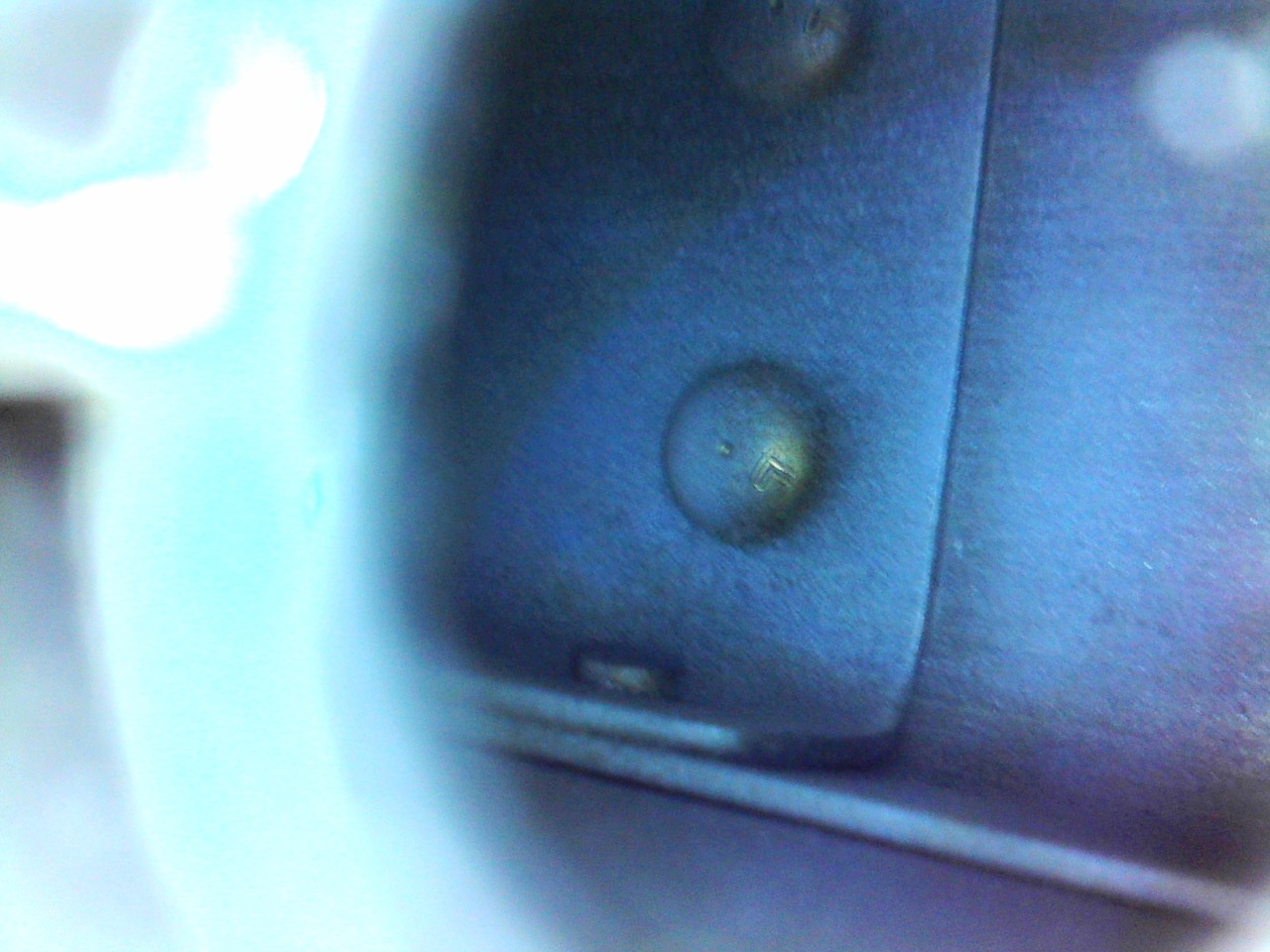

I purchased one of these cheap endoscopes also except I got mine off bay. Mine came direct from China in less than 2 weeks and was about $22 with a 15 meter cord. Fooling around with it at home after I got it, I found the picture/video quality pretty good after I stopped moving it around and gave it time to focus in. I purchased it specifically for assisting me do thorough condition inspections. I am in the middle of condition inspection and will see how it works for this SB next time I get to the hanger.

PostPosted: Tue May 10, 2016 12:41 pm    Post subject: Service Bulletin Reply with quote
Sorry, I had intended to do that. Here are a few pictures from the cheaper Amazon camera.
I had to play around with the light strength a little and found it would gain down based on reflected light but by running the power all the way up or down then back to medium I could get a good look, at least for a short time. The pictures actually looked better on the screen, but still not going to win any resolution awards. These are actually reduced so as not to crush anyone’s inbox, this email is 811kb whereas it would be 4.8mb full size if that helps at all.
I used the little mirror that came with it, it stays very secure so I didn’t worry about it popping off someplace inconvenient.
Marcus
[img]cid:C288E905-0DF8-454A-9201-E702E76F100E(at)hsd1.va.comcast.net.[/img][img]cid:27890526-9C52-45D4-9953-F4794E65555A(at)hsd1.va.comcast.net.[/img][img]cid:3AD2DC3F-6258-4DB5-83BE-AA3775E0823D(at)hsd1.va.comcast.net.[/img][img]cid:760B6C4E-F65C-4FAA-87AE-C4CBD3920B34(at)hsd1.va.comcast.net.[/img]On May 10, 2016, at 3:46 PM, Tim Olson <Tim(at)MyRV10.com (Tim(at)myrv10.com)> wrote:
--> RV10-List message posted by: Tim Olson <Tim(at)myrv10.com (Tim(at)myrv10.com)>Could you, if you get it out again soon, post a photo ofwhat the screen looks like when inspecting something, to givean idea of the quality?TimOn 5/10/2016 2:10 PM, Marcus Cooper wrote:
Just did the inspection on my -10, didn’t remove anything and used thecheaper inspection camera fromAmazon: john(at)trollingers.com (john(at)trollingers.com)<mailto:john(at)trollingers.com (john(at)trollingers.com)>> wrote:Jim,Can you attach the photos, trying to see best way to get images of the area.thanks,do not archiveOn Tue, May 10, 2016 at 12:26 PM, Jim Combs <jiminlexky(at)gmail.com (jiminlexky(at)gmail.com)<mailto:jiminlexky(at)gmail.com (jiminlexky(at)gmail.com)>> wrote: I too was able to inspect the area without removal of the flaps or ailerons. I took pictures with my Samsung phone and they turned out just fine. 856 hours total time - no cracks. Jim Combs No Archive On Tue, May 10, 2016 at 11:12 AM, Alan Mekler MD <amekler(at)metrocast.net (amekler(at)metrocast.net) <mailto:amekler(at)metrocast.net (amekler(at)metrocast.net)>> wrote: --> RV10-List message posted by: Alan Mekler MD <amekler(at)metrocast.net (amekler(at)metrocast.net) <mailto:amekler(at)metrocast.net (amekler(at)metrocast.net)>> were they able to inspect both places without removing anything? Alan > On May 10, 2016, at 10:39 AM, iMac <cgroote1(at)yahoo.com (cgroote1(at)yahoo.com) <mailto:cgroote1(at)yahoo.com (cgroote1(at)yahoo.com)>> wrote: > > --> RV10-List message posted by: iMac <cgroote1(at)yahoo.com (cgroote1(at)yahoo.com) <mailto:cgroote1(at)yahoo.com (cgroote1(at)yahoo.com)>> > > This morning the FBO here used their borescope on my -10. There was enough room without doing any extra work. Time - minutes. > > > > =========== -List" rel="noreferrer" target="_blank">http://www.matronics.com/Navigator?RV10-List =========== FORUMS - eferrer" target="_blank">http://forums.matronics.com <http://forums.matronics.com/> =========== WIKI - errer" target="_blank">http://wiki.matronics.com <http://wiki.matronics.com/> =========== b Site -   -Matt Dralle, List Admin. rel="noreferrer" target="_blank">http://www.matronics.com/contribution ===========
http://www.matronics.com/Navigator?RV10-Listhttp://wiki.matronics.com
 Filesize:  176.76 KB
 Viewed:  25940 Time(s)
 Filesize:  183.44 KB
 Filesize:  173.52 KB
 Filesize:  226.12 KB

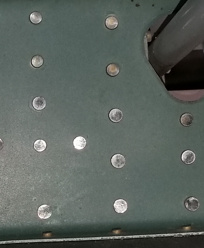

PostPosted: Tue May 10, 2016 4:46 pm    Post subject: Service Bulletin Reply with quote
Trying to post this for the third time.  (Images too large!)
I used my Samsung Galaxy S5 Cell phone camera to take pictures.  I have attached the raw and cropped photos for reference.  I only attached the right side so as to not clutter up the forum with picture data.  I reduced the size of the "Raw" image to allow it to post.  but you can see what the camera took before I cropped and zoomed the area of interest.
Turn on the flash, auto-focus and insert the camera in the inspection hole with the camera just inside the hole and the phone resting on the edge.  Take the picture and then crop / zoom in on the area of interest.  Did the same thing on the outside with the aileron up and down.
Both sides took 20 minutes.
I think this is good enough to do the inspection.  Someone correct me, but I don't think removing the flaps and ailerons exposes much more of the area?
Aircraft has 856 hours over 5 years of flying.
Jim C
On Tue, May 10, 2016 at 1:55 PM, John Trollinger <john(at)trollingers.com (john(at)trollingers.com)> wrote:
Jim,
thanks,
On Tue, May 10, 2016 at 12:26 PM, Jim Combs <jiminlexky(at)gmail.com (jiminlexky(at)gmail.com)> wrote:
Jim Combs
