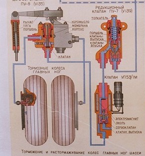

I had this exact same issue today when I put the parking brake on for preflight. Brake on, hiss under the rear floorboard, brake off, no hiss. I still have brakes on each side, it's just constantly bleeding down while the brake is applied. What did your issue end up being?
I know there's a brake valve, pressure reducer, and distribution valve in there from the schematics, but I'm unsure where they are or what the most likely culprit might be.
Any help or ideas would be very appreciated!

I forgot to mention the brake reducing valve is the unit in the upper
right corner of the photo.� Look at the shape.� That's what you'll be
removing.

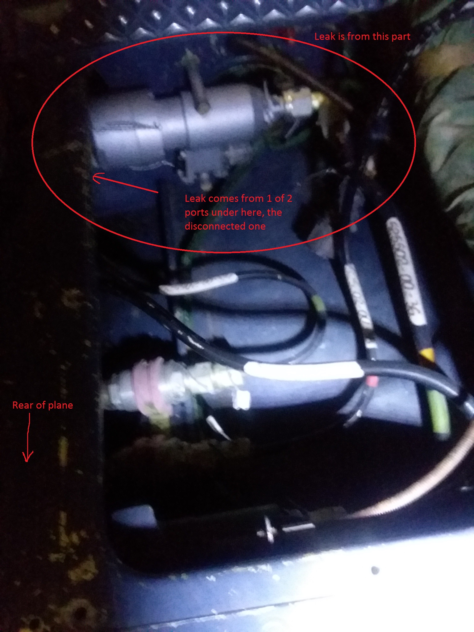

I got the floor panel off and the leak is coming from a port on the valve in the right bottom of Dennis' photo. There's a male threaded port on bottom that does not have an air line attached, and when I apply the parking brake, air continuously comes out that port.
If the reducing valve is in the top right of the pic, what is this valve? Strange that it blows out that open port. I'm assuming it is there for a reason and doesn't need capped.
Thanks for the help!

Remove the brake reducing valve and either replace it or rebuild it. That should fix your problem.
Dennis

Thanks Dennis, so this is the reducing valve? You had said the reducing valve was in the upper right of your picture, and this is in the lower right, so just confirming before I buy a replacement (noone seems to have kits right now).

Yes, the brake reducing valve is in the upper right of the cut-away drawing I sent you.  The other two components are the brake disabling solendoid (lower right) and the brake differential valve (left side).
When you said "no one seems to have kits right now", I'm assuming you did check with Doug Sapp, the CJ parts supplier?
