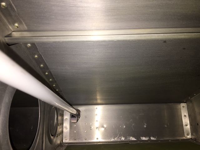

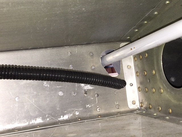

FWIW, I did my inspection today in about a half hour. iPhone photo in each of the outer access panels works great (see attached) as you can pinch to zoom in very well.
I have a small, articulating borescope that I slipped down on the aft side of the spar and was able to take a look at the 2 hidden rivets, the rest you can see by just moving the aileron up and down. With a borescope, no need to drop the aileron and cut out that section.
BTW, no cracks noted on either side.
