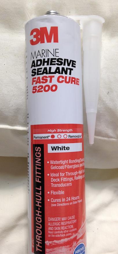

On my RV8, Todd, the maker of Todd’s canopies, came to my hangar and I helped him cut, fit and glue the RV8 canopy to the frame. No screws anywhere.
Todd had me get 2 tubes of 3M Fast Cure 5200 sealant (only used one tube). I documented the whole process well and you can see it on his website: http://www.toddscanopies.com/tips-for-rv8.html
I’ll never use another screw in plexi again, and this 3M adhesive is very easy to use as compared to the sikaflex.

Interesting. The 5200 is supposed to be non-removable, so I didn't want
that, because chances are, I'll be replacing my rear window in the
first couple years. I bought my plexi drill bits from Avery back
when they got a bad batch. So I have some holes with chips and
cracks here and there. Not much I can do with it at this point.
So I can't use 5200.
Also, on the RV-14, it's not really an option to do a
screwless canopy. They do so much for you that all of the
screw holes would be in the canopy even if you did a
screwless install.
Today I ordered 3M 4000 UV. I can't use the 3200 because
it's silicone and not paintable. So I had to either
get the 4000 UV, 4200 FC, or 5200. And I didn't want
it to be non-removable.
Hopefully it'll install pretty easily.

The stuff you have pictured is white. On the RV-14 the
inside of the window will be visible. I bought black due to
this. When you use 5200, is the inside covered up by
something? Just curious. I don't intend to paint the
inner strip of canopy, but that would be about my
only choice.
