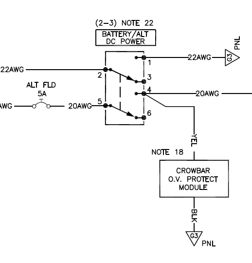

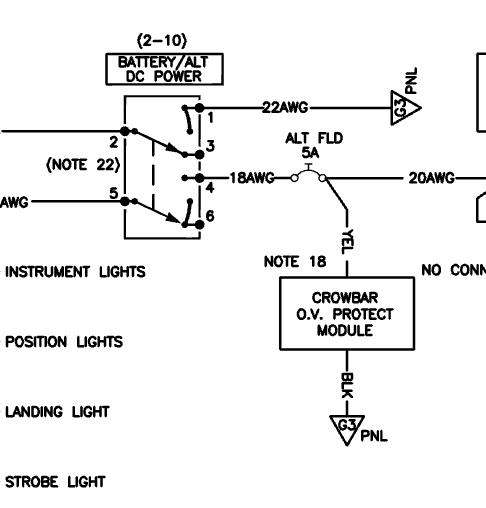

For some reason I am really getting confused about the.  Batt/master switch and how it is wired.  I am using a clarling toggle,  S2077 I believe. It has three positions.  I think this switch is a On/On/On type.  You want one position for everything off.  One for Battery only and one for Battery and Alternator.  When I look at the diagram of the switch for page Z-11 it appears that one position connects the Battery only, one connects the battery and the Alt. and one is off. It appears that the one position connects with Term 3 and six which are used as the off position.
Am I even close on this ?

Your analysis seems correct to me. I could not find part number S2077. B&C part number is S700-2-10. Since no wires are connected to terminals 3 and 6, that position (down) must be off.
Terminal 1 is connected with the switch either centered or fully up.
Terminal 4 is connected only with the switch fully up.

Z13/8 doesn't show a progressive transfer battery
master. It shows a simple DC master ON/OFF wherein
the alternator can be disabled by pulling the field
breaker. The switch called out is the simple
DPDT/ON-ON S700-2-3 device (B&C part number)
[img]cid:7.1.0.9.0.20160430141011.06238b18(at)aeroelectric.com.0[/img]
Figure Z-11 shows the progressive transfer
S700-2-10 switch that emulated the split rocker
switch popularized on many single engine aircraft
over the years.
[img]cid:7.1.0.9.0.20160430141011.06238b18(at)aeroelectric.com.1[/img]
Examination of the schematic symbol illustrates
internal functionality of the DP3T/ON-ON-ON
device.
EITHER style of switch can be used . . .
