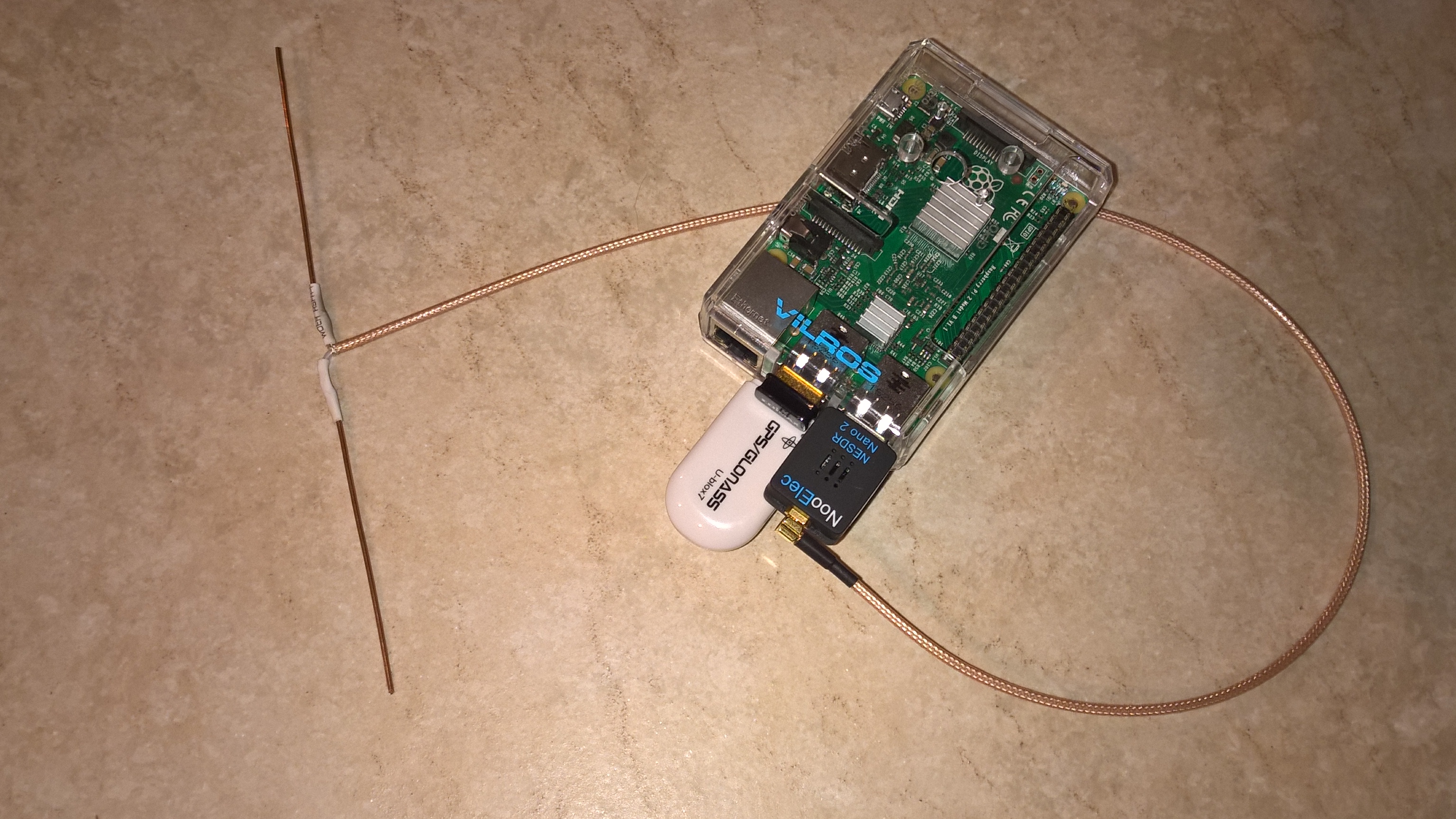

After reading good stories of different antennas I decided that I need to give shot as well.
I ordered couple coax cables from eBay. I cut two 5.9" long 16 GA copper wires and soldered those to coax cable. I tested it today and I received weather at my house.
Attached you have a picture of my single SDR configuration with "simple antenna". I have other SDR for 1090 MHz.
