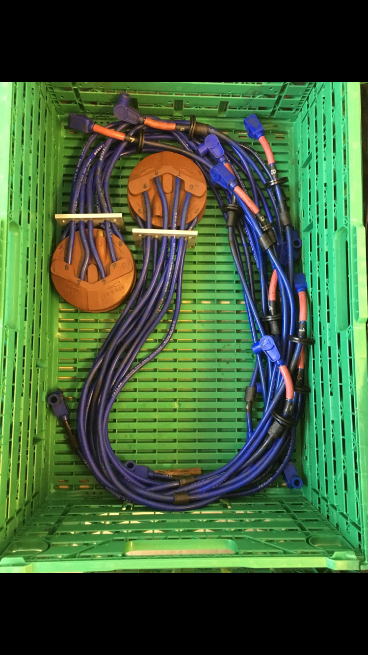

Most likely its in perfect condition so if anyone wants it? I sell it cheap.
Trade for a kit with new original spark plugs Could be a Good offer:-)
Br
Havard
[img]cid:60A7D533-FF8F-451C-BF78-6ED6FCF20CAD[/img]
Sendt fra min iPhone
