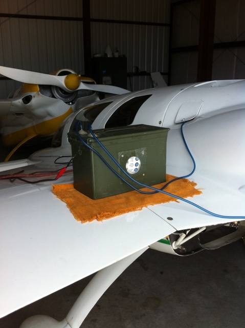

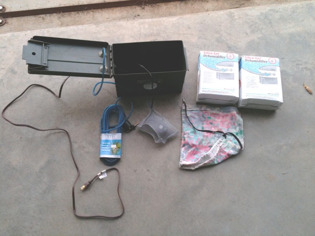

Pardon me for sidestepping your question but it might be simpler to make a dehydrator with an ammo can, the aquarium pump you mention, and use a light timer for a few hours a day. The silica will work for months and can be dried in the oven fairly quickly and reused. Pics below. I have had to replace a low-time cam and lifters due to rust. When I come back from flying, I blow the moisture out of the engine with a small air-mattress pump and hook up the dehydrator. I wrapped the pump in screen wire and put it in a bag to breath; cover it with the silica gel. 500g silica packs are pretty cheap on ebay.-Kent
