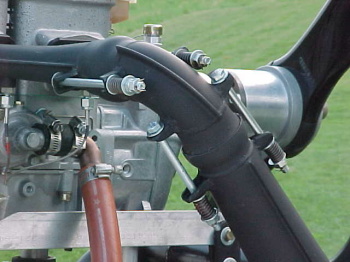

Silicon? Safety wire? Um - no. How about some 5/16" bolts and springs from Ace hardware? The lugs that the bolts go through are cut off the ends of some big muffler clamps and welded to the pipes. Drill a hole in the end of the bolts and put a cotter pin through them. Replace them every year during condition inspection.
Don't know how a 912 exhaust is configured, so it might not work for that application.

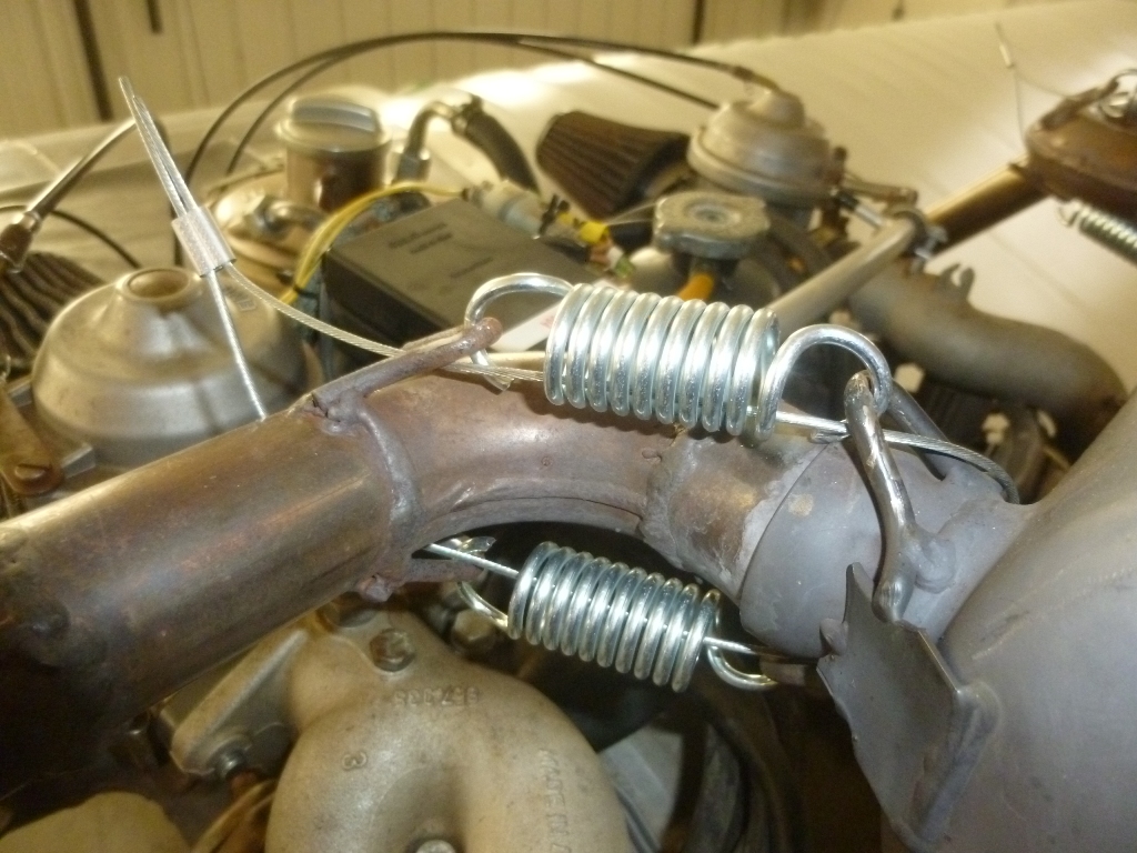

Kolb Friends -
After sharing my broken spring (and subsequent broken prop blade) experience
with the List, a few of you asked to see a picture of my fix. Here it is.
On my 912 muffler setup, one piece of braded bike cable easily secures two
springs. You can see the swaged ferrule that secures the cable ends just
above the carburetor dome.
