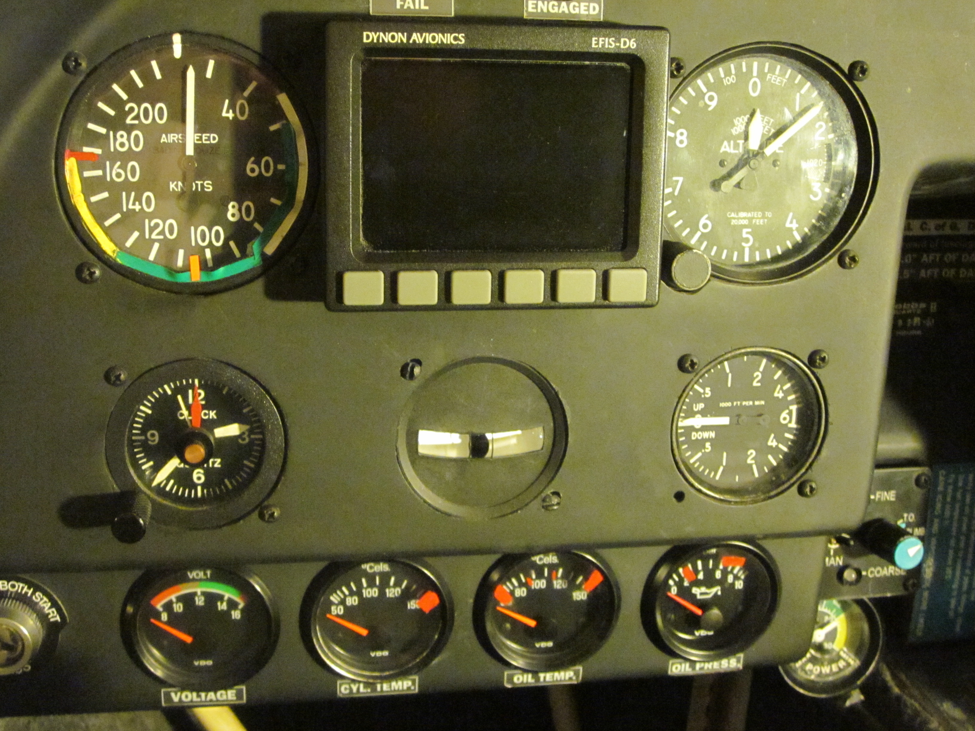

I've had no trouble with my little Dynon D6. It fits perfectly into the hole for the old AI and the square sides of the EFIS just touch the edges of the ASI and Altimeter. The compass remote sensing unit in the rear fuselage gives an accurate read-out across the top of the display.
Recently I replaced the balance ball, which is duplicated in the EFIS, with the VSI and the Airmaster prop controller now occupies the hole where the VSI was. A "slimline" balance ball now sits close under the D6.
