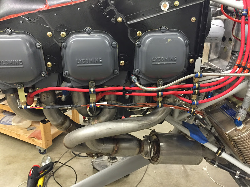

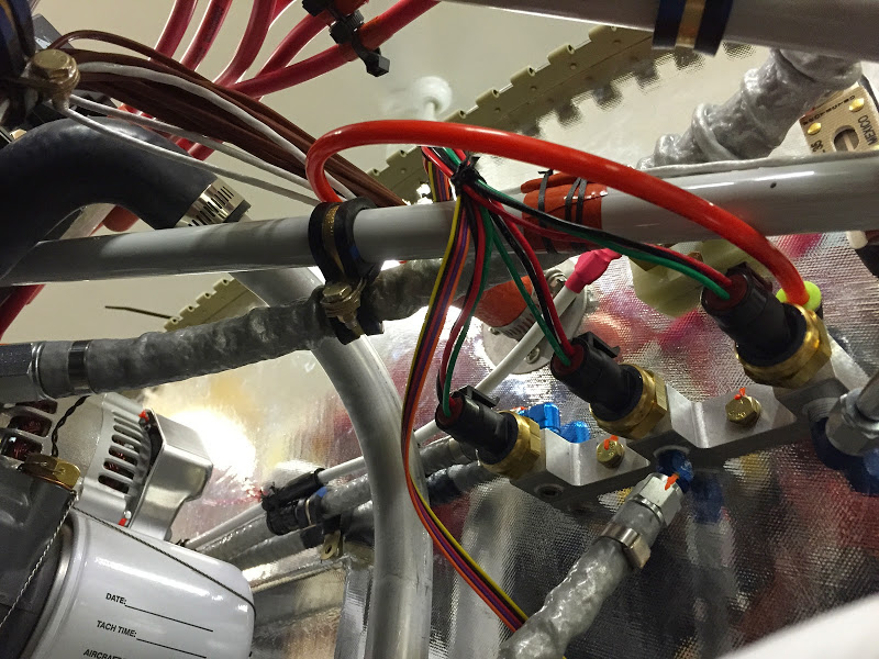

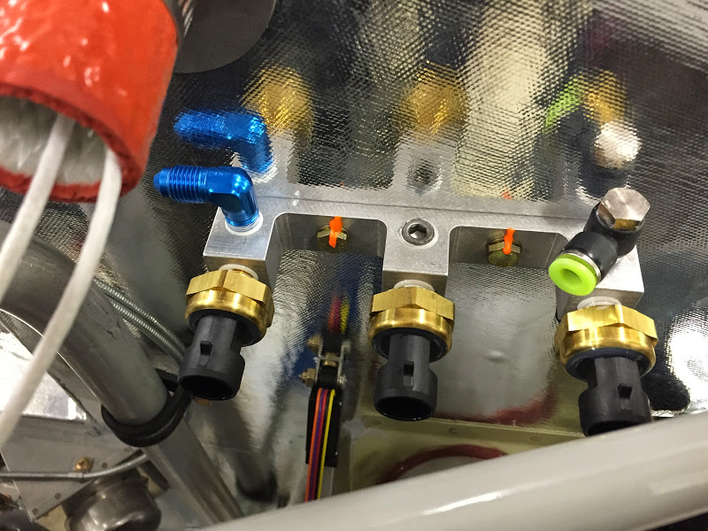

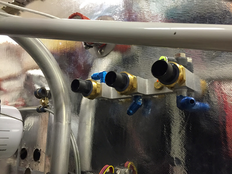

PostPosted: Wed Apr 27, 2016 6:06 am    Post subject: Manifold pressure sensor Reply with quote
I did the same as Phil. Mounted the MP sensor on the firewall sensor block. I also used the extra hole in the sensor block to daisy chain the MP into my lightspeed boxes.
Attaching a few pics of the sensor block. From left to right: Oil pressure sensor, fuel pressure sensor, MP sensor. I have the MP on the right because I'm pulling the MP source off of Cylinder 6, instead of 5 like the plans call for. The red plastic line from the MP sensor is the line that feeds my Lightspeed boxes.
By pulling MP from cylinder 6, and mounting the MP sensor there, I was able to re-use the stock MP install kit braided hose.

PostPosted: Wed Apr 27, 2016 6:40 am    Post subject: Manifold pressure sensor Reply with quote
Thanks Ed
That is exactly the pictures and the information I was looking for.
I will use the 3rd position of the firewall sensor block, will also use the Van's braided hose and connect to cylinder #6 as well.
Carlos

>> Ed Kranz <ed.kranz(at)gmail.com> 4/27/2016 10:05 AM >>>

Thanks Ed
Carlos
