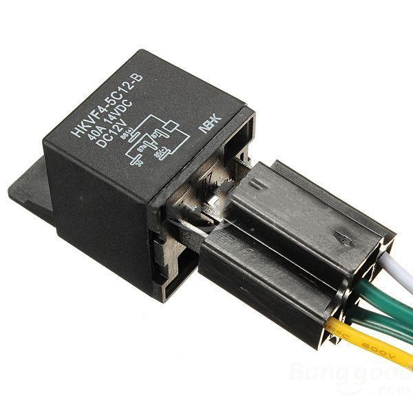

PostPosted: Tue Apr 19, 2016 7:39 pm    Post subject: Powering the EFIS system Reply with quote
On 4/19/2016 10:55 PM, David Clifford wrote:
So I understand this,,,,the buss will always have power to it no matter the switch position?
No.  When the SPDT switch is in the 'off' position it supplies power to the relay which is 'on' and the NC contacts remove power to the buss.
It's the inverse of what most builders will do .... SP switch on, relay on to supply power to the buss through the NO contacts.  With this wiring method the relay is not needed if the switch has the proper current rating.  I don't know what David's panel current draw really is but think it's way less than 30 amps.
Fuses are there to protect the wires from excess current, not the equipment attached.  So, if you have 6 ea. 5A fuses ..... that's 30A! If every electrical item in my plane is on and stable I draw less than 6 amps.  Strobes on startup and radio transmitting will add some more.
Linn

stein(at)steinair.com
PostPosted: Wed Apr 20, 2016 12:09 pm    Post subject: Powering the EFIS system Reply with quote
While you can build this up yourself much cheaper (you can get a standard relay with the diode in it for around $15 or so) , but basically this is the same thing we do for our customers and have pre-wired it for them with the relay, buss bar, etc.. all ready to go…
http://steinair.com/storedetail.cfm?productid=672
Cheers,
Stein

davidsoutpost(at)comcast.
PostPosted: Wed Apr 20, 2016 1:19 pm    Post subject: Powering the EFIS system Reply with quote
I used one of these I had laying around from another project. Its mounted behind the IP on the sub-panel, and is wired with 10 gauge from my main 12 volt power stud to the fuse block. Fuse blocks I used are from Steinair. The fuse blocks are mounted also behind the IP on the sub-panel. Fuse blocks are behind the pilot side accessible by removing the GDU 370 & GDU 375 displays. Sorry but I don't have a picture handy

 Filesize:  66.31 KB
 Viewed:  13492 Time(s)

Bob Turner
Joined: 03 Jan 2009
Posts: 885
Location: Castro Valley, CA
PostPosted: Wed Apr 20, 2016 5:32 pm    Post subject: Re: Powering the EFIS system Reply with quote
I don't like the 'wire the relay backwards (avionics on when relay off)' approach.
1. Every time you turn on the master you give your radios a short pulse of power (until the relay pulls up)
2. If your starter pulls enough current to result in 'brown-out (significant drop in buss voltage) your avionics power relay may drop out at exactly the wrong time - subjecting your avionics to a low voltage. Some modern avionics do not tolerate low input voltages very well.
At the least I'd look for a relay with low drop out voltage ratings.
Switches and relays are cheap enough to put in two, one for backup.
Bob Turner
RV-10 QB
flying-nut(at)cfl.rr.com
PostPosted: Wed Apr 20, 2016 6:02 pm    Post subject: Powering the EFIS system Reply with quote
That's OK too. I'd hate to have a failure of either the switch or relay
.... wired conventionally ..... that killed all my avionics.
I've never hung a 'scope on the avionics buss, but I suspect the
avionics inrush current would keep that pulse rather small.
I have 'exit sign' batteries for each of my two EFIS panels as backups
for alternator/ships battery failure. I can power up the EFIS without
turning on ships power. No brownout, no reboot no matter how low the
ships power gets.
Not a bad idea.
Linn
