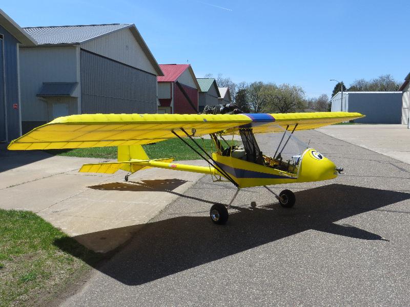

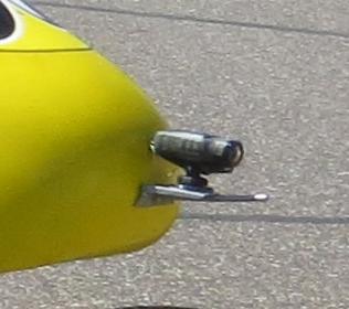

I mounted it on the nose, attached on a plate above the "P" tube

Thanks for the pictures, that was fast. Is it "springy"? The more solid it is the better the video. Other wise you will have to figure what RPM gives you less jumpy video.  I used a 1x1/8th flat stock about 5 inches long, twisted 180 so that I could use a hole drilled in the side to secure the cradle.
