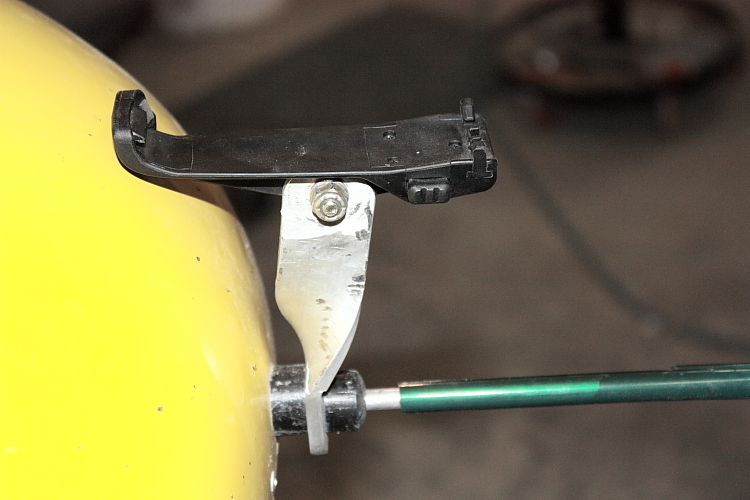

Stuart, Thanks for the videos. I assume that you are using a Virb Elite? I was a bit surprised at the clarity of them. The last was a lot more like it. I checked the settings on mine and found that it was set to 1080P- Ultra zoom- format NTSC. Lens correct was on as well as the stabilizer. Those setting seem to render a video close to what I see with my naked eye.
I have checked all over my Firestar and the only place that will give me the least amount of jello and other crap is on the end of the nose pod, and secured as solid as I can get it. I have a screw in pitot tube holder (plastic from AC spruce) I took a piece of alum flat stock, bent half of it 180 degrees and mounted my cradle on it. It just clears the pod. I tried one of the stick on holders and it was not as good as the alum for some reason.

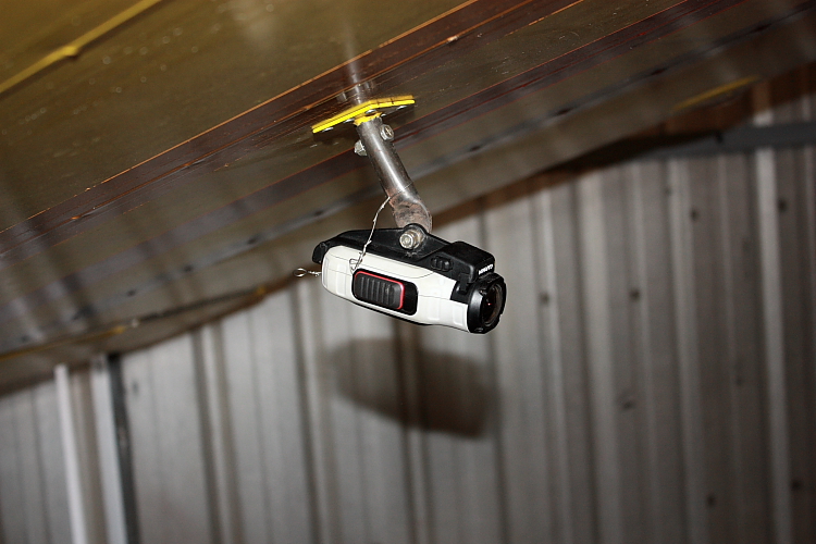

The other spot that isn't all that bad is the wing. Of course if you fold it each time , that isn't going to work.
You will also find that there is some rpm ranges that will cause jello. For me and the HKS with a Max cruise of 5800 RPM, I find that either 5400 or faster is as smooth as it gets for me. So if you are getting jello, do a flight and mark your RPM's and try different speeds and see which works the best.
