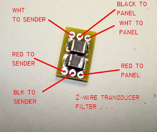

I can send you an itty-bitty filter that wires into the
transducer leads within short distance of the
victim as identified by experiment . . .
[img]cid:.0[/img]
What are the wires between the EIS panel connector
and the transducer? It would be good if they were a
twisted trio with all panel end wires terminated
at the EIS connector.
[img]cid:468541322(at)12042016-1608[/img]
[img]cid:328085723(at)12042016-160F[/img]

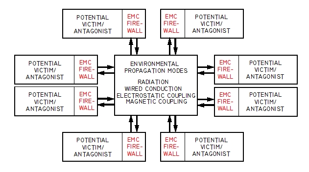

These situations illustrate the value of doing
the homework fo system designers. Here's a
rough illustration that peeks into the risks
for living in the wild and wooly world of
electromagnetic noise.
[img]cid:.0[/img]
In aviation, the diagram can be quite simple . . .
perhaps only three v/a blocks. In a J-3 with no
electrical system, two of the blocks would be
a magneto, the third block might be a hand-held
transceiver. The magnetos would never be victim,
the hand held never antagonistic. But swap out
the mags for electronic ignition systems and they
too are at risk from VHF emissions.
In the Hawker 4000, there were no doubt hundreds
of devices. Each one representing the potential for
being victim, antagonist or both.
The 'fire walls' are critical components of any
design intended to thrive in a hostile/vulnerable
environment. This is what DO-160 testing is all
about. DO-160 is only one of hundreds of qualification
protocols . . . each one tailored to a specific
application.

This illustrates the small but real risks for
buying a perfectly good device (like a fuel
pressure transducer) intended for a low-tech
terrestrial application only to find that it
gets fussy when bathed in radio frequency energy
from an aircraft comm radio.
The short answer: It's useful to know which fire-wall
is too short . . . or non-existent. Is it the
transducer, the panel instrument or perhaps
both? Then, is there some error of installation
that compromises the fire wall(s). A common error of
installation is a disconnected shield in the
antenna coax of a transmitter that causes the
feed line to radiate the whole cockpit with RF
energy that exceeds the height of some system's
fire wall.

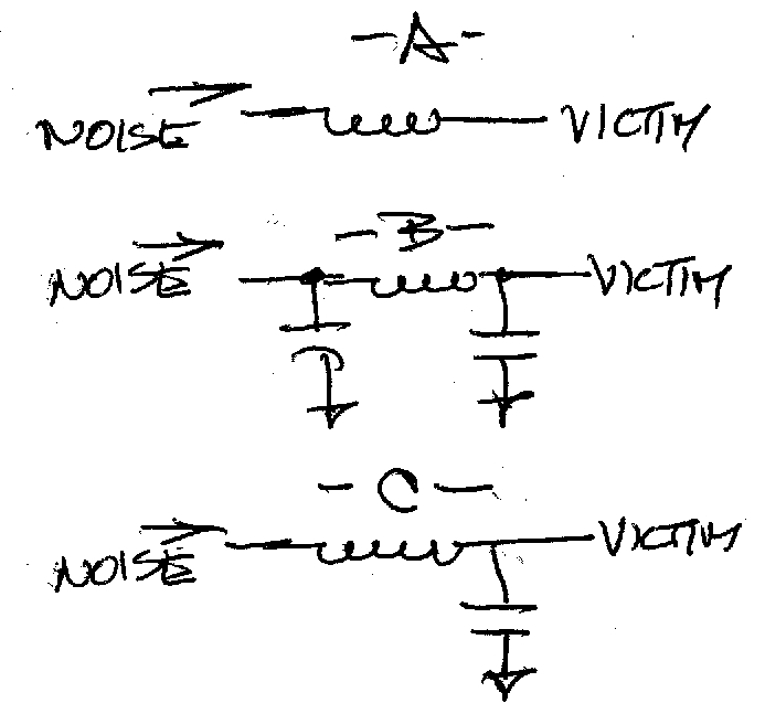

The down side of beads-only attempts to fix
is rooted in the unknown value of a paralleled
SHUNT effect downstream of the SERIES effects.
[img]cid:.1[/img]
In the sketch above, view -A- illustrates the effect
of adding series impedance on a wire where shunt
impedances are at best unknown or worst . . . insignificantly
small. This is often the case where adding the
ferrite 'helps a little'. Ideally, we'd like to see
a combination of series/shunt effects like -C- or
even -B-. The itty-bitty filter I illustrated earlier
[img]cid:.2[/img]
has TWO circuits like -B- above with values
unlikely to upset purely DC signal or power
paths. However, one would not want to put
this device in a USB or serial data line . . .
the components would have deleterious effects
on the desired signals.
The nagging unknown about the case under discussion
is "what changed?" Knowing that answer would
probably provide the short-path to a solution.
Two separate comm systems PLUS a hand-held
will disturb the victim to varying degrees so
a broken coax shield ground can be ruled out.
Given that the affected system was not modified,
then we're encouraged to explore spontaneous
changes within the affected system . . . difficult
to do. Conversely, we're left with the selection
and application of band-aids. From a user's
perspective, a band-aid cure that reduces effects
to zero meets an operational goal. From an
engineer's perspective, not knowing the exact
antagonist->propagation->victim configuration
is frustrating.

PS - re your itty-bitty filter:
1. how big is it? perhaps put a penny in the picture
2. when you designed the filter, what frequency are you trying to filter? I'm guessing it's somewhere in 110-140 MHz but what about harmonics?
3. are those tiny surface-mount components an inductor & a cap? (or is it the case that: "you could tell me but then you'd have to kill me?" Wink
