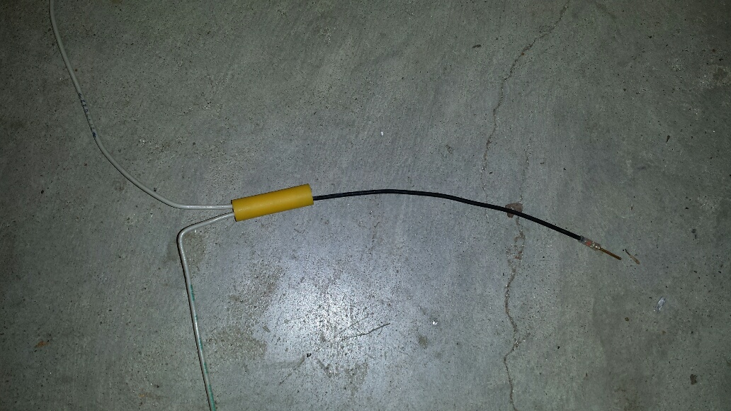

PostPosted: Fri Apr 15, 2016 12:16 pm    Post subject: CAN Bus wiring Reply with quote
Quick & dirty pic of what I mentioned earlier as a 'stub'. Ignore colors; I just grabbed what was convenient to get the pic.
Crimp or solder the 'stub' in one end of a butt splice (yellow in pic); apply your required pin to the other end. Cut into the bus backbone, and snip one of the wires in the pair. Insert *both* of the clipped wire ends into the other end of the butt splice.
Repeat for the other wire in the pair.
Assuming you've kept the shield on the backbone, if you can cut into the cable without actually cutting the shield (yes, it can almost always be done), then tape it up & you're done. If not, or you want a cleaner look, manage the shield as shown in Bob's book, with insulated stubs on each shield with a butt splice on the shield stubs. The shield does not need to enter the node's connector.
Charlie
 Filesize:  279.58 KB
 Viewed:  6950 Time(s)
Charlie
