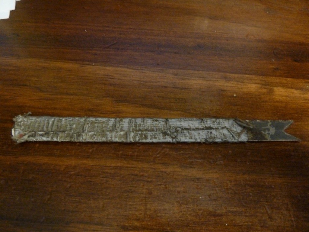

First, drive out the old mandrel prior to a drilling attempt. You can buy a 1/16" punch that works great, or use spent mandrels. First grind one end square (flat). Use small Vise Grips to hold the mandrel. The drive them out.
To prevent the rivet from spinning while drilling I made a small tool out of a piece of hack saw blade. I grind a notch in one end, beveling on one edge. Push this under the rivet head as far as possible to lock the rivet.
If the rivet is not for a structural part, I use common hardware store aluminum rivets. Easy to drill out. All my Lexan is attached with aluminum rivets.

John Hauck wrote:
Kolbers: <snip>
<snip>
Yep. Works like a champion. Sharpen the beveled notch edges with a Dremel.
 Filesize:  157.93 KB
 Viewed:  8818 Time(s)
Richard Pike
Kolb MKIII N420P (420ldPoops)
Kingsport, TN 3TN0
PostPosted: Tue Apr 12, 2016 1:39 pm    Post subject: Alloyed aluminum on our kolbs... Reply with quote
Richard Pike
Kingsport, TN 3TN0
I used the corner of a bench grinder to do mine. The little homemade tools
I use for pop rivets in the tin can with my pop rivet gun and snap punch,
must be 30 years old. Can't wear them out and they didn't cost anything to
start with.
