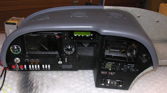

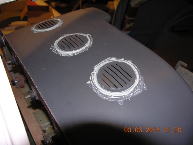

Who uses fans, who uses ram air? How do you route your solution?
Bob…I have 3, 120 mm computer fans w/ louvers directing air towards windshield…instrument module is spaced 1/2” from firewall and holes cut in bottom for intake air and circulation...
Not flying yet…no verification of actual performance.
Fred

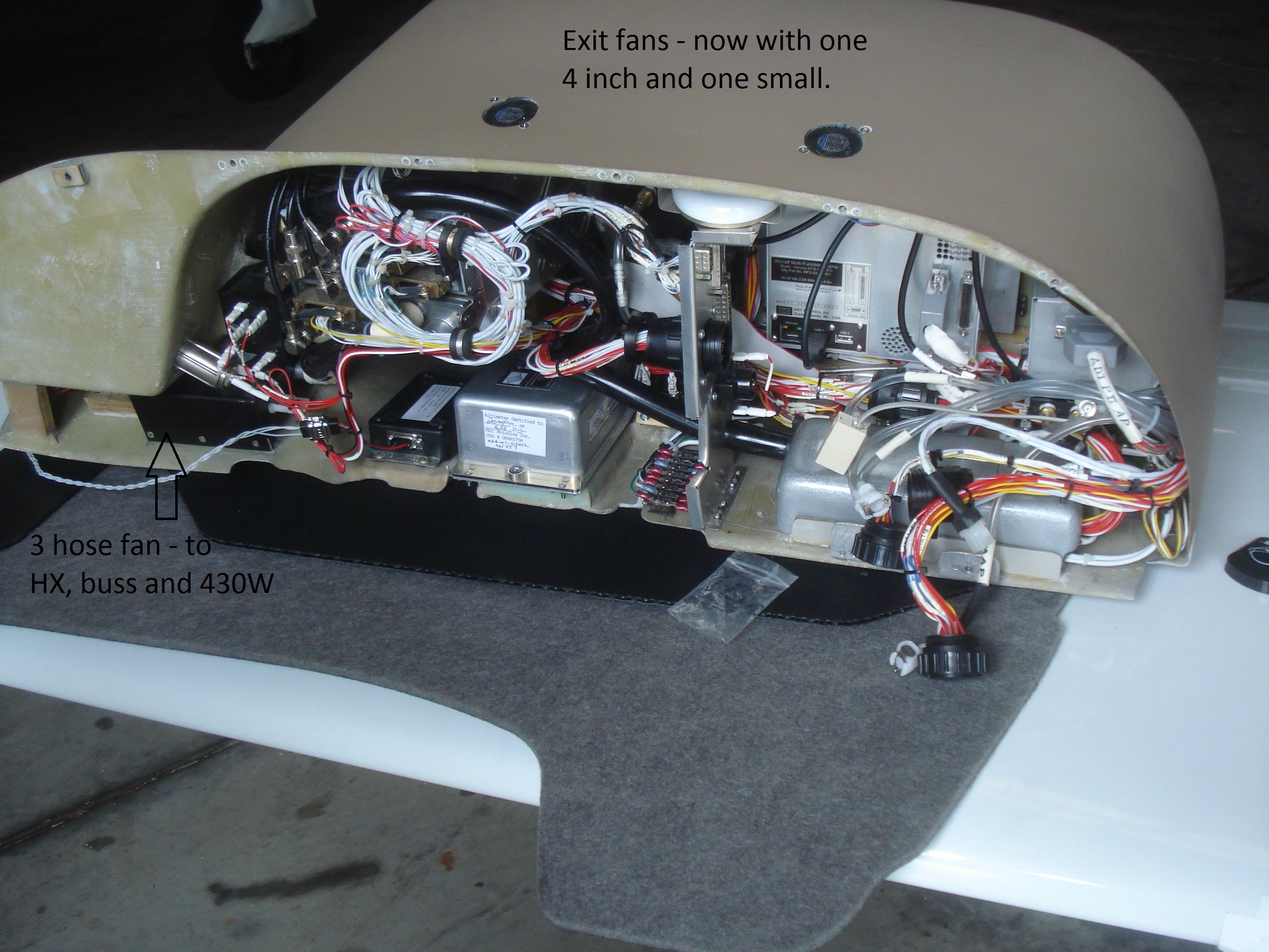

In the attached picture you can see my panel. I (with the terrific help of Bud Yerly of Custom Flight) made the panel easily removable – takes about 10 minutes to remove the entire panel. This has paid off some many times, and makes doing IFR 2 year checks very easy if the inspector wants to check everything.
My plane is IFR with a Garmin 430W, a 330 GTX Mode S transponder, a Grand Rapids HX, an engine monitor, a Tru-Trax 2 axis autopilot, and several steam gauges. Yes, it all fits but it is tight. And it is heavy - 42 lbs. for the panel. And it produces a great deal of heat. So we put in a three hose fan drawing air from the passenger foot well, and two exhaust fans – original two inch (as shown) but now one is a 4 inch fan. The top fans are on a thermostat and a timer, running off the secondary battery. When I land, if the temps are up in the panel, the fan goes on for about 45 minutes.
The three hoses from the fan go to the HX, 430W, and the EXP buss box (on the right side of picture with all the plugs over top of it). The box was made to improve cooling and keep stray wires or dropped tools from causing shorts in the EXP buss). The two hoses - to the Garmin and to the HX are not in the picture.
The secondary battery also runs the radio and trim and autopilot through a “soaring” buss for use when the engine is off for soaring (I have the glider wings also), and can be used for clearance delivery on the ground so you don’t have to run the engine (and possibly overheat) or wear the main battery down when getting your clearance. I do have the top mounted, belt driven 45 amp alternator as well as the standard 20 amp Rotax alternator. Even if I lose the HX or the main battery I still have the Tru-Trax to keep wings level and to get heading. The steam gauges give me altitude, speed and climb/descend rate. And in extremis the Foreflight gives me an additional backup.
I do have a spare handheld ratio with its own antenna with a connection to the secondary battery if I lose the Garmin. It is not tied into the intercom system so I have to plug it into my headset if I want to use it.
After getting the system up and running I have had no problems keeping the heat down behind the panel. I did originally have panel heat problems when doing my flying off time in Florida in the summer – outside temps at altitude above 95 degrees F.
Good luck. I think the work necessary to make the panel removable is worth it. I would also recommend making the connections to the engine easy to disconnect so you don’t have to cut anything when the engine needs to be removed.
The system works great and the Europa is great IFR platform, except I could occasionally use another radio – but no room. Just takes some planning.

Your description and picture was very helpful. From your picture I presume you have used the LONESTAR CYCLONE - 21 COOLING FAN. My Europa mono XS has been flying for some sixteen years now and I have owned her for eight years. The panel has built in inspection points already, and is also moveable, so hopefully access should not be a issue.
I am not the original builder, but do fly regularly with him. Great knowledge source and buddy. (He spends half his time in the UK, and like you winters in Florida). Half a dozen differing solutions to the problem set. This forum is an outstanding knowledge resource.
Many thanks for your suggestions.
