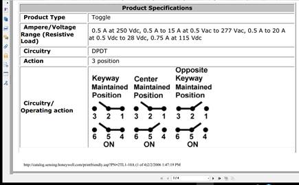

I want to utilize a master switch like the Honeywell 2TL1-10A for the Master/Alternator switch in the Z-14 DBDASB. I like it because it has locking positions.
The data sheet switch contact description did not look like I expected it to. Can someone PLEASE look at the data sheet below and tell me if it will work for this application???
THANKS!!!
Bill Hunter

Yes, if I am interpreting the datasheet correctly, that switch will work.
Mount the switch with the keyway down.
Connect the alternator field to teminals 2 & 3.
Connect the master contactor to terminals 5 & 6.
As for the current rating, I do not understand it. But since the maximum current under certain conditions is 20 amps, then most likely the switch will handle 5 amps at 12 vdc.

If anyone out there in AeroElectricLand is interested in using this
Honeywell 2TL1-10A switch for their Battery Master + Alternator Master then
I have taken Joe's written instructions and mapped them out on a PDF copy of
the data sheet with red being the path of the Battery Master entering at
pole #6 and exiting at pole #5 and blue being the path of the Alternator
Field entering at pole #3 and exiting at pole #2.
THANKS AGAIN Joe!!!
