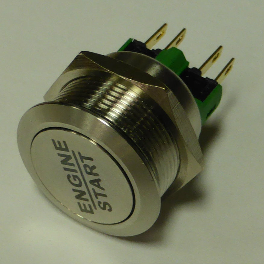

I am curious about the function of the pictured "Engine Start" switch. It is a push button switch with four terminals on the back. Two of the terminals are normally open, two are normally closed. I can see how the normally open terminals could be used to drive a starter motor relay, but what would the typical use be for the normally closed terminals on an engine start switch? See attached pic.

PostPosted: Mon Mar 28, 2016 3:38 pm    Post subject: another switch question Reply with quote
Just a guess……ground out one of the mags?

PostPosted: Mon Mar 28, 2016 3:51 pm    Post subject: another switch question Reply with quote
To remove power from anything not needed while cranking the engine.

PostPosted: Mon Mar 28, 2016 4:53 pm    Post subject: Re: another switch question Reply with quote
This looks like the 'Steinair' switch they sell, (which I'm keen on using on our -9a build) the connectors look like 1/8inch wide, are 'fast-on' PIDG connectors available, or should one solder.

PostPosted: Mon Mar 28, 2016 6:55 pm    Post subject: another switch question Reply with quote
Hi Ken;
That's a mighty rugged looking switch! I think the normally closed contacts would normally be used to turn off (temporarily) anything you didn't want running while engaging the starter.

PostPosted: Mon Mar 28, 2016 7:00 pm    Post subject: another switch question Reply with quote
Hi Ken;
I would like the mfg. and model number of that switch, please.

PostPosted: Mon Mar 28, 2016 8:17 pm    Post subject: another switch question Reply with quote
It's made by Elewind. Here's a link:
http://www.aliexpress.com/store/product/ELEWIND-22mm-1NO1NC-Momentary-push-button-With-ENGINE-START-symbol-PM221F-11-S-With-ENGINE-START/737142_1719523504.html

PostPosted: Mon Mar 28, 2016 11:25 pm    Post subject: another switch question Reply with quote
I don't know if the manufacturer would have anything to add, this is obviously an automotive based switch so what the NC contacts would be used for in a modern car is anyone's guess - and the advert states the contacts are rated 2-5 amps

ARGOLDMAN(at)aol.com
PostPosted: Tue Mar 29, 2016 5:01 am    Post subject: another switch question Reply with quote
My guess is that it is a somewhat standard pushbutton switch back to which the manufacturer attaches a "start" placarded front.
Just ignore the nc part. If you really want you can use the NC part to disable other electronics during your start, however you add one more point of failure to a switch of possible questionable reliability.-- With this switch, if it fails, so you can't start your craft (you are probably on the ground at this point) whereas if it fails you may not have use of the electronics that it defeats.

PostPosted: Tue Mar 29, 2016 7:11 am    Post subject: another switch question Reply with quote
Content-Type: image/jpeg; name="engine-start-switch.jpg"
Content-Disposition: attachment; filename="engine-start-switch.jpg"
X-Attachment-Id: f_imcjusoz0
I would guess that the n.c. side disconnects
accessories not intended to be on the bus
during cranking. I think all my cars drop
the accessory bus during cranking.

PostPosted: Tue Mar 29, 2016 7:39 am    Post subject: another switch question Reply with quote
Thanks guys. I can't see any reason to utilize the NC side in my installation.

PostPosted: Tue Mar 29, 2016 10:38 am    Post subject: another switch question Reply with quote
Hi Bob
Looking at this switch, it's a double pole changeover style: if used as a simple (on)-off (ie: momentary push on - to power the starter contactor) is it a good idea to connect the terminals together, or is one pole OK for a standard starter contactor
