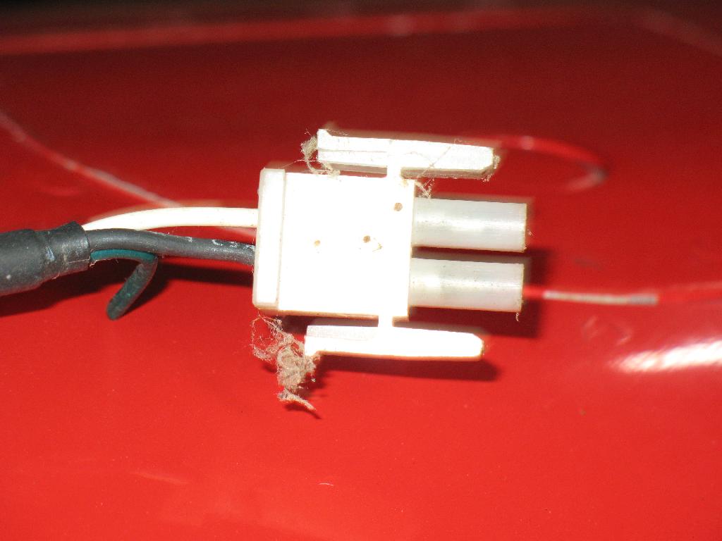

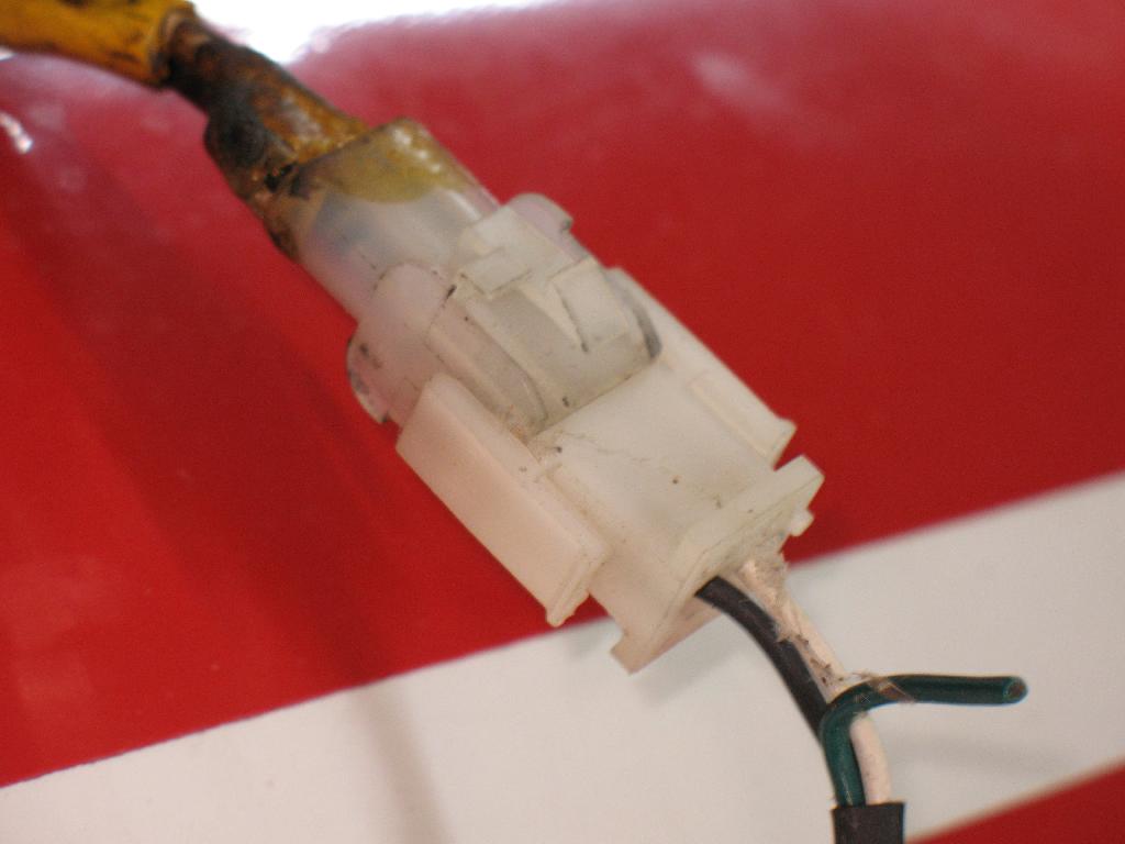

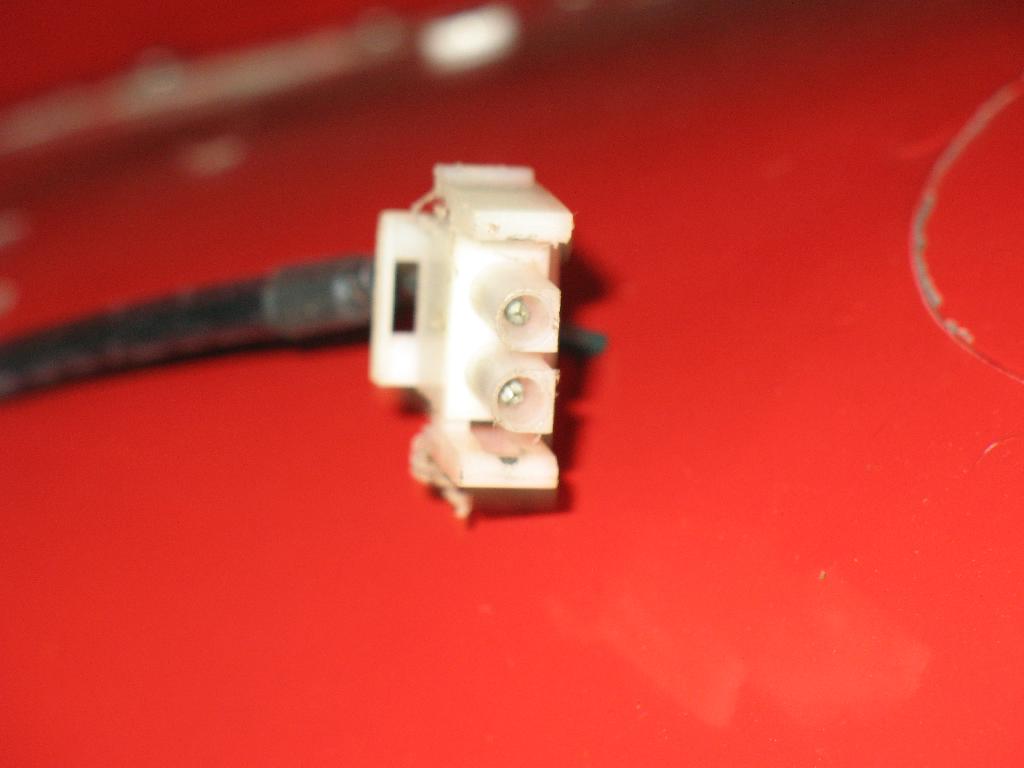

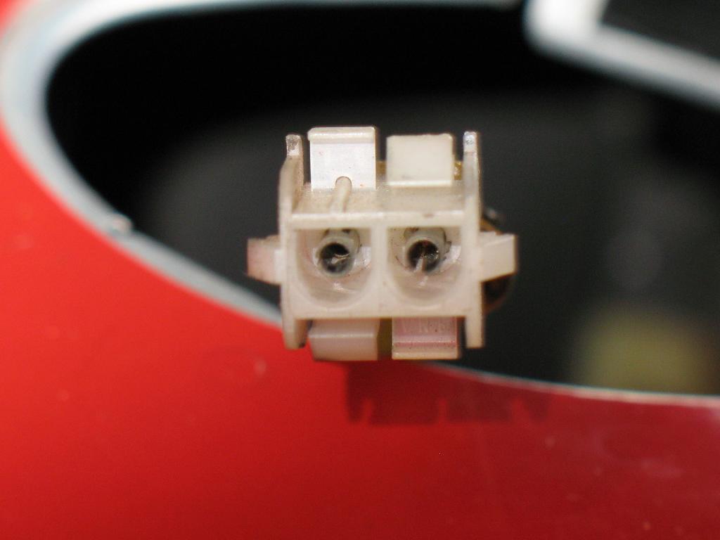

Hi all,
I need to duplicate this 2-pole interlocking connector used for the battery maintainer, but don't seem to be able to find an exact match. Can anyone help with a P/N, manufacturer ?
Rumen

ARGOLDMAN(at)aol.com
PostPosted: Tue Mar 29, 2016 11:06 am    Post subject: 2 pole connector Reply with quote
Looks kinda like a molex mate -n-lock. No biggie if you can't find it, just replace both with ones that you can easily get. (see Digi-Key )

rick(at)beebe.org
PostPosted: Tue Mar 29, 2016 11:15 am    Post subject: 2 pole connector Reply with quote
I think it's an AMP Universal MATE-N-LOK connector
I think the side with the clips is a TE CONNECTIVITY / AMP 1-480698-0
and its mate is TE CONNECTIVITY / AMP 1-480699-0
Check page 37 of http://www.farnell.com/datasheets/1492314.pdf
Newark carries them.
--Rick

rd2(at)dejazzd.com
PostPosted: Tue Mar 29, 2016 11:22 am    Post subject: 2 pole connector Reply with quote
Thanks. Looked up molex and amp, couldn't find an exact match. Replacing would be more involved; that's what I was trying to avoid.

rd2(at)dejazzd.com
PostPosted: Tue Mar 29, 2016 12:12 pm    Post subject: 2 pole connector Reply with quote
Thanks a lot, this seems to be the one; a number of vendors carry that p/n, I am placing an order.
RD

skywagon
Joined: 11 Feb 2006
Posts: 184
PostPosted: Tue Mar 29, 2016 1:43 pm    Post subject: 2 pole connector Reply with quote
. . . Hmmm. . . that is an odd one. .
Might be easier to cut it off and connect a new, match pair that is easy to
find if needed again. . .
rd2(at)dejazzd.com
PostPosted: Tue Mar 29, 2016 3:44 pm    Post subject: 2 pole connector Reply with quote
Already ordered a few AMP/TE ones that were suggested, due to closest resemblance. Hope they are the same. If not, will just rewire both sides.
RD
