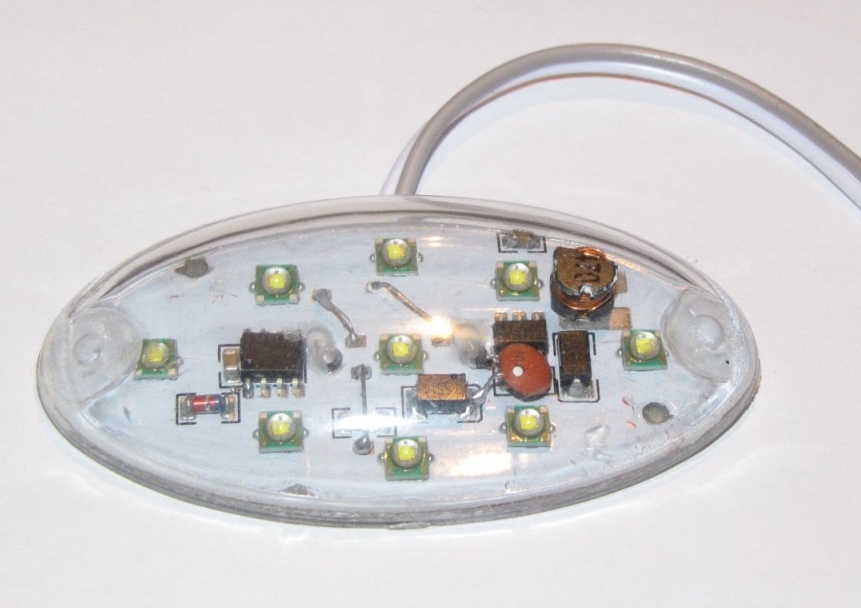

Do I presume correctly that you're working with devices that look like
this?
[img]cid:.0[/img]
Kinda cute . . . but not very reassuring from the perspective
of design for EMC. Minimized radiation from high frequency
power supplies BEGINS with tightly clustered components
with short leads to minimize the radio frequency radiation
footprint. That sprinkling of parts gives pause for doubts.
If your lamps are different, shoot me pictures or links and
a link to the installation instructions. We may have to
conduct some experiments to identify the noise propagation
mode . . . Might have you send me one to bench check. I just
bought a spectrum analyzer that would help identify the device's
un-neighborly behaviors.
