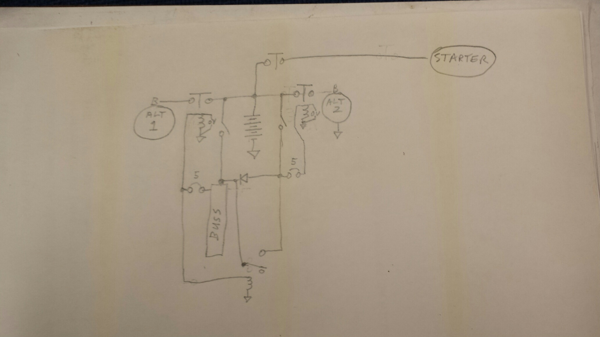

Greetings,
I need a sanity check on my current thoughts for the charging circuit in my RV-7.
Please note that this is *not* a typical Lyc installation, so many of the assumed requirements/limits do not apply.
Engine: Mazda Renesis automotive conversion with total electrical dependency.
Alternator(s): 2 ea identical ND internally regulated alternators, each rated at 60 amps.
(This choice was driven by both budget constraints and simplicity of installation)
My goals/choices are:
1. 'Unlimited' availability of electrical power, to avoid in-route diversion in the case of alternator failure. I accept a single battery,due to the very small likelihood of battery failure. Fuel will easily outlast any but very big/heavy batteries. A PC680 is good for only ~45 minutes with only the engine consuming electrons; much less time with avionics on line.
2.Redundant paths of power to the buss, due to the engine's total dependence on electricity.
3. Ability to check both alternators for proper operation before flight.
4. Optional 'auto-start' for 2nd alt, if alt1 goes offline for any reason.
5.Since the auto engine accessory end allows the 'backup' alternator to be the same size as the primary, I'm willing to use one buss and shed individual loads manually, if multiple failures require it.
6.Continuous electrical load for the engine/fuel pump/instrumentation is ~15 amps at full engine output (yes, it varies). This may seem high, but with high pressure injection pumps and injectors, plus high energy automotive coils, this is pretty 'normal', and has been verified by others running similar systems.
7.Balance of additional avionics & other loads, assuming night flight with heated pitot on, would be an additional 27 amps, worse case. There's minimal likelihood of flying this plane in those conditions, but it could happen, so...
8. Intermittent loads of significance would be: fuel transfer pump (8A), flaps (10A), and landing light (5A).
The attached rough sketch shows the IR alternators controlled by regular continuous duty solenoids incorporating Bob's OV modules for OV protection.
The two switches supplying (redundant) power to the buss are 50A DC rated toggles (not a hard requirement, but simpler than additional contactor/switch pairs).
The diode (high current Schottky's are cheap these days) is to prevent powering alt2's contactor control circuit unless alt2's switch was closed, but provide a redundant path from battery to buss.
I desired 'autostart' for alt2, so I added the contactor circuit drawn below the buss. It's intended to be a normally closed relay, held open by the same circuit that supplies power to alt1's contactor.
As I type this, I realize that the NC relay needs a diode between its output terminal and the 5A CB, so that it can't be required to carry buss loads when alt2's switch is closed.
Any issues with performing a 'mag check' (output check) of the two 50A switches and their alt's, with the engine near idle power & minimal loads? (I'm aware of 'load dump' issues when cycling IR alts at high power.)
A related question I'd like an answer to is this: If using internally regulated alternators, is there any issue with leaving both on line at the same time, if they are diode-isolated?
Sorry for the long post, but I thought a detailed narrative was required. Remember, auto engine, identical dual internally regulated alternators.

PostPosted: Fri Mar 25, 2016 5:16 pm    Post subject: Re: Charging circuit: Sanity check Reply with quote
The relay under the bus will always be energized whenever the main bus is on, unless the 5 amp breaker is tripped or pulled off. I do not understand its function.
It is my understanding that two alternators on line at the same time will fight each other and cause the system voltage to oscillate unless the voltage set-point of one of them is set a few tenths of a volt below the other one.
Consider using contactors or heavy duty relays instead of 50 amp switches. Relays allow remote control so that power can be shut off near the battery. That feature is important in the event of a forced landing or crash to prevent sparks from igniting leaking fuel.
Consider supplying power to the man bus at both ends.

PostPosted: Fri Mar 25, 2016 8:25 pm    Post subject: Charging circuit: Sanity check Reply with quote
Joe Gores
Joe,
Thanks for the reply. Just took another look at my rough sketch; I drew
the switch arm incorrectly for the way it is intended to operate. The
relay in question is SPDT; the 'on' state drives the switch element away
from the load. Opening alt1's CB removes power, passing power through
the other CB to alt2's contactor.
I haven't ruled out using contactors, but prefer the switch option. Not
included in the rough drawing are planned fusible links on the lines
feeding the 50A switches. I agree with the concern, but after a post
mentioning similar setups in certified a/c (likely without fusible link
protection), I decided to explore the option. The 'upside', at least in
my head, would be removing all the extra failure points that show up
with the extra components. (The two alt contactors & starter contactor
are all within a few inches of the battery and each other, so should
need no extra protection.)
I've heard the same thing about regulator 'hunting' if there are two
alts feeding the same buss, but the examples given seem to be of
externally regulated alts. I do know there are twins with I am curious
about whether this will happen with internally regulated alts. Even if I
must forgo simultaneous operation, I hope I can still do a pre-takeoff
check by pulling alt1's CB & opening the switch (or contactor..) on that
side. Not crazy about pulling the CB before each flight, but it *is* a
pull-able breaker. And I'd probably only do it on cross countries, where
I'd really need alt2 for endurance.
Charlie

PostPosted: Sat Mar 26, 2016 8:48 am    Post subject: Re: Charging circuit: Sanity check Reply with quote
If both alternators are online at the same time,
over voltage on one alternator could cause both
over-voltage modules to short and trip their breakers.
Considering that many modern avionics can operate
between 12 and 30 volts, automatic over-voltage
protection might not be necessary. The battery might
resist voltage rise for a minute until the pilot reacts to
the EFIS high voltage warning and shuts off the alternator.
There is no automatic switch over to alternator 2 because
that bottom relay will never drop out while the main bus
is hot unless alternator 1 breaker is pulled or tripped.
The bottom relay will have to be able to handle full main-
switch #2 current because very little will flow through
the diode. The relay contacts short out the diode.

PostPosted: Sat Mar 26, 2016 1:01 pm    Post subject: Charging circuit: Sanity check Reply with quote
Thanks, Joe; responses inserted below.
On Sat, Mar 26, 2016 at 11:48 AM, user9253 <fransew(at)gmail.com (fransew(at)gmail.com)> wrote:
--> AeroElectric-List message posted by: "user9253" <fransew(at)gmail.com (fransew(at)gmail.com)>
You're right, of course. Looks like the only option would be to diode isolate the alts outputs from each other, and do OV detection behind the diodes. Unfortunately, that induces up to .45V drop, even with Schottky diodes. Might be able to get away with that & still charge the battery properly; might not. Would be nice to be able to adjust an internally regulated alternator's output...
True, but I'd prefer not to depend on my reaction time if the event comes during at high workload time. Will keep that option in mind.
Correct. I've been focused entirely on OV events, and neglected the *under*voltage possibility. Perhaps I can live with that; with undervoltage alerts from the EFIS and battery capacity, I should have a longer safe response window.
Correct, and I noticed that as I was typing the 1st email. I think I mentioned an omitted 2nd diode.
I've attached a revised drawing with the additional diode, and the NC relay in the correct position. I also  added a fuse link to the feed line for the auto-transfer supply, for wire protection. Consider the auto-transfer components below the 'hash' line as optional, but desirable to me.
As drawn, I should be able to pull alt1's CB, close alt2's main supply switch, and start the engine. (Start control not included in the drawing.) After engine start, verify 14V from alt2, then close alt1's main supply switch, open alt2's supply switch, and close alt1's CB. Then verify 14V from alt1.
As mentioned in a previous email, I'm not crazy about resetting the CB every flight, but CB specs seem to indicate ~2500 cycle life for pullable CBs, so it might get the same treatment as Bob's 'battery rotation' concept and be replaced at every 4th or 5th annual. (Even that would be overkill for me; I don't fly that often.)
An OV fault should bring alt2 online automatically, and I'll add detection to the auto-transfer relay to get notification if it activates alt2.
I'll depend on the EFIS for under-voltage notification and bring alt2 online manually by pulling alt1's CB (would also remove any potential load caused by the defective alt1).
Still not locked-in to using the 50A switches, but am still leaning that way. Should have drawn the fuse links in this revision, but forgot. Won't forget to install them, though. Smile
Thanks again, Joe. Any more thoughts, anyone?

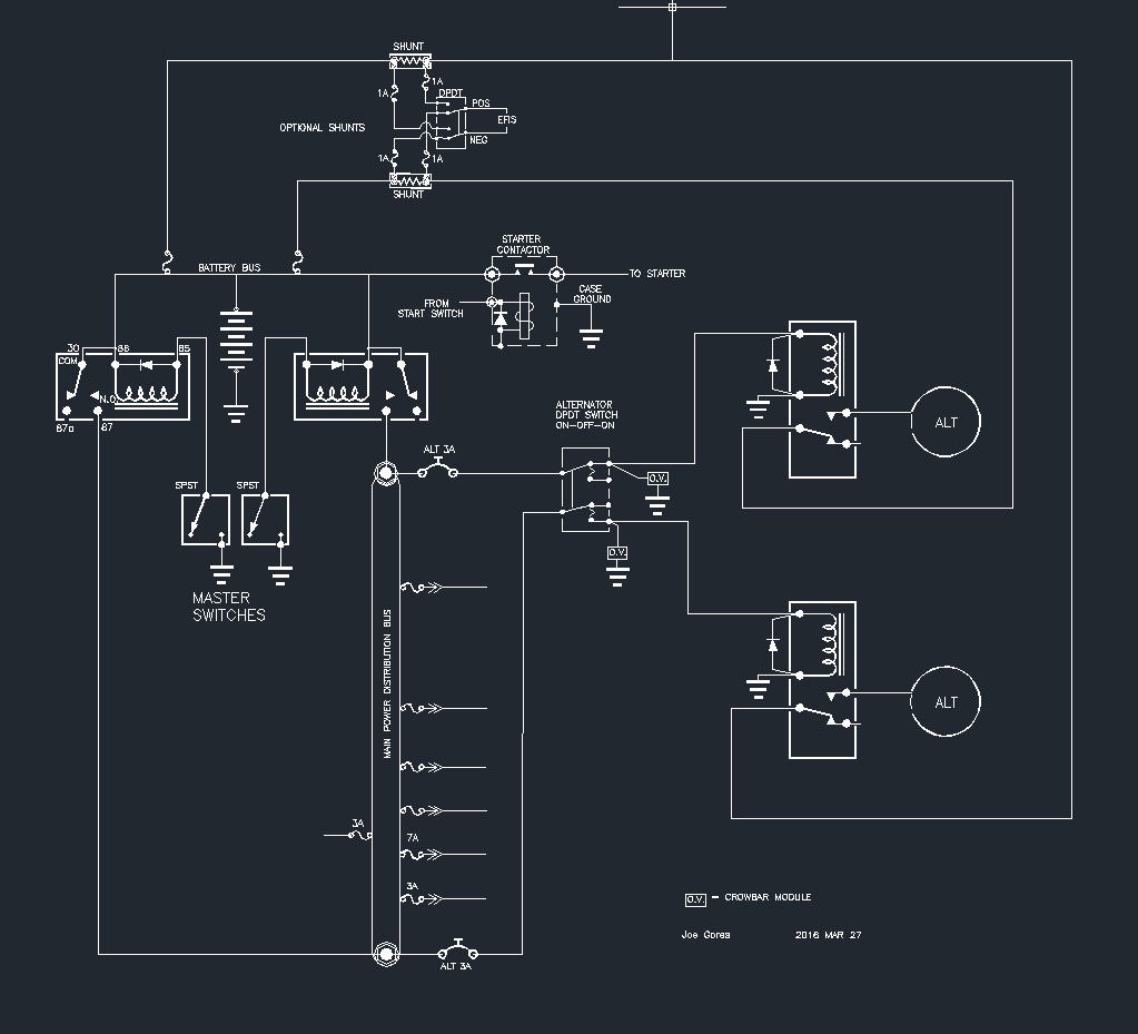

Here is a schematic for you Charlie
 Filesize:  81.87 KB
 Viewed:  12290 Time(s)
Charlie.pdf
Download
 Filename:  Charlie.pdf
 Filesize:  19.21 KB
 Downloaded:  454 Time(s)
Joe Gores

Take a peek at this drawing
http://tinyurl.com/zpww8ag
and see if it doesn't do what you want.
All engine stuff runs off battery bus. E-bus has dual
feeds one of which mitigates loss of battery contactor.
S/B alternator feeds battery directly which also
goes to mitigating loss of battery contactor. Simple
controls with no hazard to system for having more than
one alternator active.

Looks good, but do I need multiple busses, when I'll be running 2 identical alternators? The auto conversion engine has the advantage that I'm not restricted to a vacuum pad mount for the 2nd alt, like a Lyc would be. So the entire aircraft's electrical loads can be supported by either alternator.
I'd prefer internally regulated alternators, as well. I've followed others' issues with them in the past, but I've used them on my RV-4's for years and I'm comfortable with them. I won't be 'load dumping' unless the alternator has already failed. My only real concern would be pre-flight testing of both alternators. My hope would be engine start with only the backup alternator on line, check for proper operation, then take the backup off line (while operating at low power) and bring the primary on line to verify its operation.
Do you see any issues with this?
Charlie
PostPosted: Sun Mar 27, 2016 2:30 pm    Post subject: Charging circuit: Sanity check Reply with quote
Not sure what you mean . . . eliminate the e-bus? Sure, you can do that.
Understand. The drawing as submitted supports that requirement.
That's what I have illustrated . . .
Load dumping damage is a will-o-the-whisp that arose from the smoke with alternators popular in the RV crowd many years ago. I think those were some product offered by Van's. Read the chapter on alternators for a description of how ANY alternator remanufactured by ANY reputable shop demonstrates MULTIPLE max rpm, max load, max temperature load dumps.
You can do that. In fact, the airplane can be routinely flown on either alternator.
That or any other combination of switch-flips are equally valid . . .
I've revised the drawing to eliminate the e-bus. You still want to connect the s/b alternator directly to the battery so that shutting down the DC PWR MASTER gets the electrical system max-cold . . . for smoke in the cockpit events. See http://tinyurl.com/zm46jzm

One bus is OK, but consider:
Is it possible for that bus to lose power?
If it does lose power, what are the symptoms?
If loads critical to flight safety get power from
that bus, what is the backup plan?
Having two alternators does not necessarily mean that the
main power bus will not lose power. It all depends on how
the aircraft is wired.
The ignition and fuel pump of an electrically dependent
engine should be powered directly from the battery.
Joe Gores
