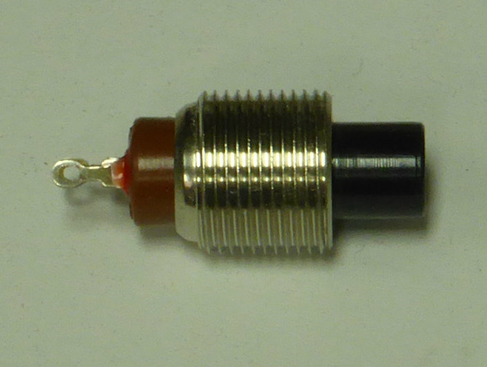

Are the terminals on this switch solder only or is there a push on connector that matches?[img]cid:ii_1539616375b04dcb[/img]

Solder !
You may find a narrow female tab which “sort of” fits but it is not an intended application and is not recommended.

Soldering a wire onto this sensor would risk ruining the sensor. I believe the intended connection method is to use a matching ring terminal on the wire. Fasten the wire to the terminal using the appropriate screw, 2 flat washers and a Nyloc nut. Certainly not my favorite type of terminal on a sensor exposed to engine vibration. A sensor like this would best be used on a transducer manifold block, mounted to the firewall. Vans aircraft sells such a manifold block. It's listed on the bottom of page 30 of their catalog. You can download the catalog here.

I think it is intended for soldering.  I don't see how you would get a slip on terminal to stay on/
You may be able to put an alligator clip or similar as a heat sink on the terminal below the solder area.  It should only take a very few seconds to get a good solder joint.
