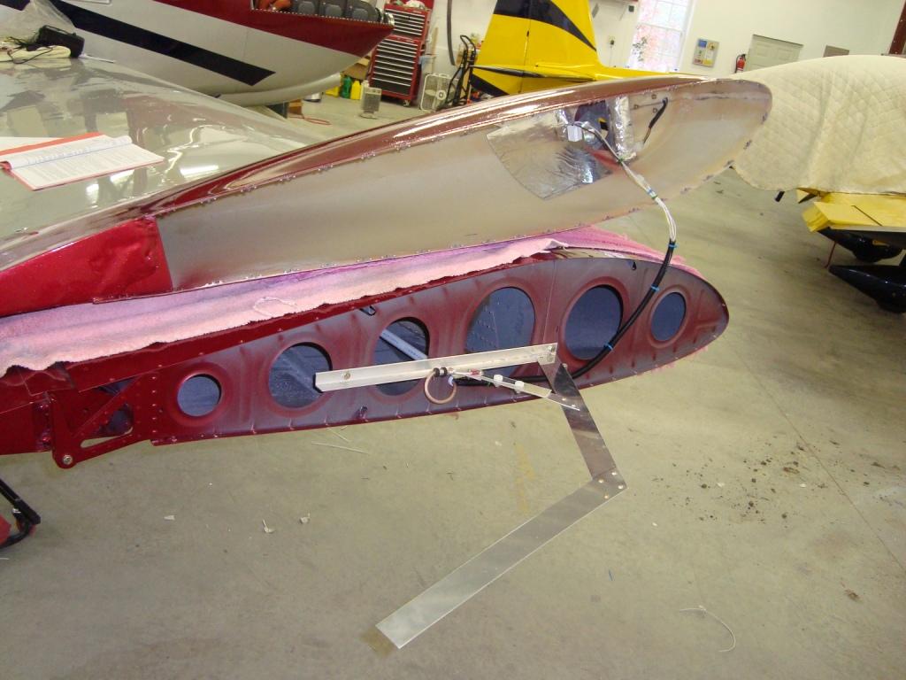

For both of my planes I built the VOR antenna and mounted it to the end wing rib on a light piece of angle (page 13-16 of the AeroElectric Connection manual, photo attached of my plane before I moved it further aft).  This way the antenna says with the wing when you take the wing tip off, and greatly simplifies tuning the antenna for resonance.  Note the antenna dimensions have been changed to take advantage of the full width and shape of the wingtip.  The antenna works quite well but if you do not have access to an antenna analyzer or a ham radio guy that has one, stick with the Archer product.
