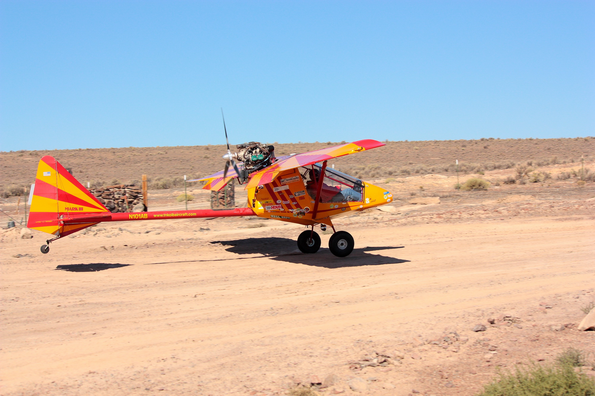

PostPosted: Thu Mar 17, 2016 5:24 am    Post subject: FireStar 2 Kit Received ! Reply with quote
I always thought dragging the tail boom straight, instead of sideways through the air, would clean it up a bit and increase cruise. The SS and Kolbra utilize that design technique with lower incidence to increase cruise. John Williamson's Kolbra, with 912ULS, same engine on my MKIII, cruised 10 mph faster at the same rpm. Top speed is about 10 to 15 mph quicker. The major difference in drag between the Kolbra/SS and the MKIII was the difference between the width and shape of the fuselage. Also, the Kolbra had less wing area because it did not have flaps. The MKIII flies slower and gets off the ground quicker.
Actually, the fuselage of the FS would have to be redesigned because the tail boom was designed to fly tail high. Flying with the tail boom horizontal would make the pilot feel as though he were laying on his back and climbing all the time.
My original Firestar was faster and flew slower than the FSII. It had full span ailerons. The FSII is like the Kolbra with half span.
I am a firm believer is extremely tight fabric. I believe this is one of the major differences between air speed/flight characteristic differences of the same model Kolbs. My MKIII has never been outrun by another MKIII. Same for my original FS. Both aircraft had fabric that bowed the tubes on wings and empennage. Soft fabric changes shape much more than tight fabric.
There were a lot of things I would have liked to experiment with my Kolbs over the last 32 years, but age caught up with me before I got them all done. Then I got to the stage that what I have now is great. It does what I need. It is an 85 mph cruise aircraft. If I can find a 15 mph tailwind, then I've got a temporary 100 mph airplane across the ground. It will carry everything I can cram into it to keep me and it going for extended periods of time. So far, the longest duration flight was 48 days. The longest flight was 17,400 sm in 41 days and 232.0 flight hours. It will keep me in the air for 5 hours, if I could do that without wetting my pants. It gets me in and out of tiny fields, two track trails, gravel bars, beaches on the Atlantic, the Gulf of Mexico, the Arctic Ocean, and small dry lakes in the dessert. It does much more than Homer Kolb and John Hauck ever dreamed one of his little airplanes would do. It takes me where I want to go. All I have to do is put gas in it, take off and point the nose in that direction.
