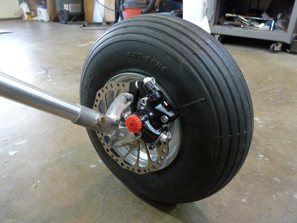

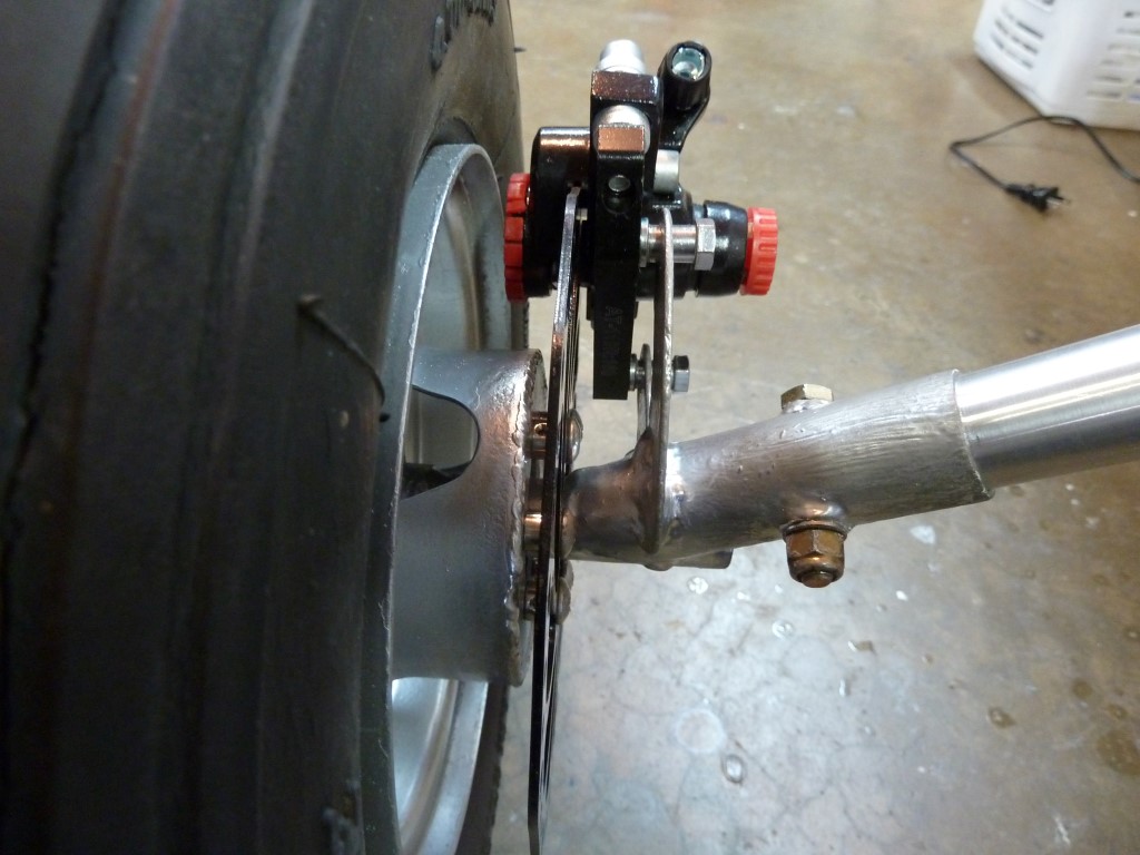

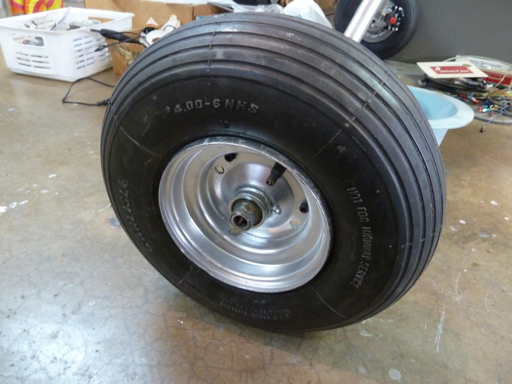

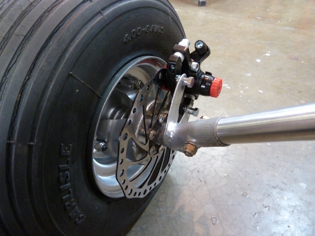

While visiting Herb to pick up a front piece of Firefly cage, he showed us some bicycle disc brakes he was puttering with, and we decided to give that idea a try. If you look on ebay, there are a lot of low cost bicycle cable operated disc brake sets available, we got one set (identical front & rear) for $33 including shipping. At that price, why not?
First picture is the Original 1985 Firestar wheel barrow wheels. Actually pretty light. Spent some big bucks and put in real bearings.
The hardest part (and it cost more than the whole brake set did!) was getting the mounts formed to shape by a muffler shop. Trued them up as best we could, welded a mounting plate on, and attached the disc to them. Runout turned out to be really good!
This is how it looks all together, they have plenty of grip, just hoping they don't tend to grab. Added about 3 pounds total weight weight to the wheels. Total investment turned out to be about $140.
Here is how we trued it up:

PostPosted: Sun Feb 12, 2017 2:32 pm    Post subject: Re: Firefly brakes Reply with quote
Very nice Job! I had originally bought a set of the bicycle brakes for my Firefly but ended up giving up and going withe the way too expensive hydraulic brakes.

PostPosted: Sun Feb 12, 2017 3:58 pm    Post subject: Firefly brakes Reply with quote
Richard...you do good work.. Smile
I used those rims for the first Firefly...but procured a set of very
true aluminum ones for the second...Having a lathe allowed me to turn a
spool..and move the rear wheel bearing into it..I then made a calliper
holder that attached to the big washer that comes welded to the Firefly
axle... By the time that I built the second set...I had collected 4 or 5
sets of front disk brakes from my favorite place to shop, the salvage
yard.....Little ugly with one cable facing the front of the calliper and
the other to the rear..
One thing to be aware of ..the cable run allows too much stretch if
it is of small diameter.. My first set were shimano since my son worked
for an outdoors company..They were a little pricy...39 dollars... Others
, I get for a buck or two..
Too...I think ,haven't checked in a while...the Chinese offer
hydraulic versions ... My trouble with hydraulics over the years...is
there are usually leaks...Smile Though I replaced 3 out of 4 brake lines
on my old Crown Vic...nary a leak! Getting better with age I guess..
though other things leak!! Smile Herb

PostPosted: Sun Feb 12, 2017 4:50 pm    Post subject: Re: Firefly brakes Reply with quote
Thanks for the comments. We had originally thought of skipping brakes to save weight. Then considered rigging a small lever pad to push on the tail wheel, just to keep it from rolling along on a paved ramp when the engine is at idle. If we did that, we would obviously be going with absolute minimal weight & brakes. And if it comes out really close to Part 103 specs, and needs just 2 or 3 pounds less to make the difference, we may end up going with that.
We are not expecting these brakes to be real great, OTOH if it turns out to be a real U/L, it shouldn't need much brakes.
