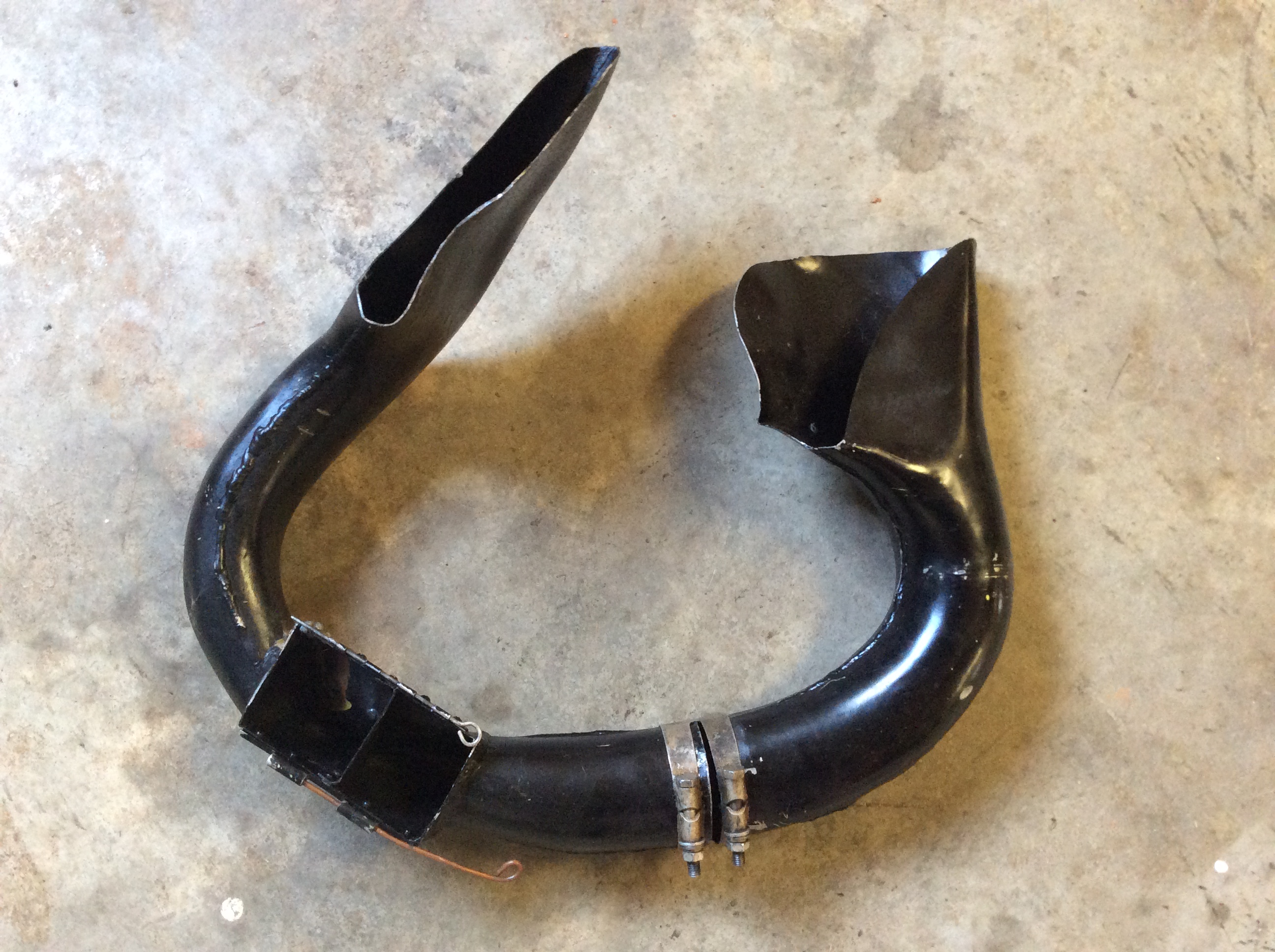

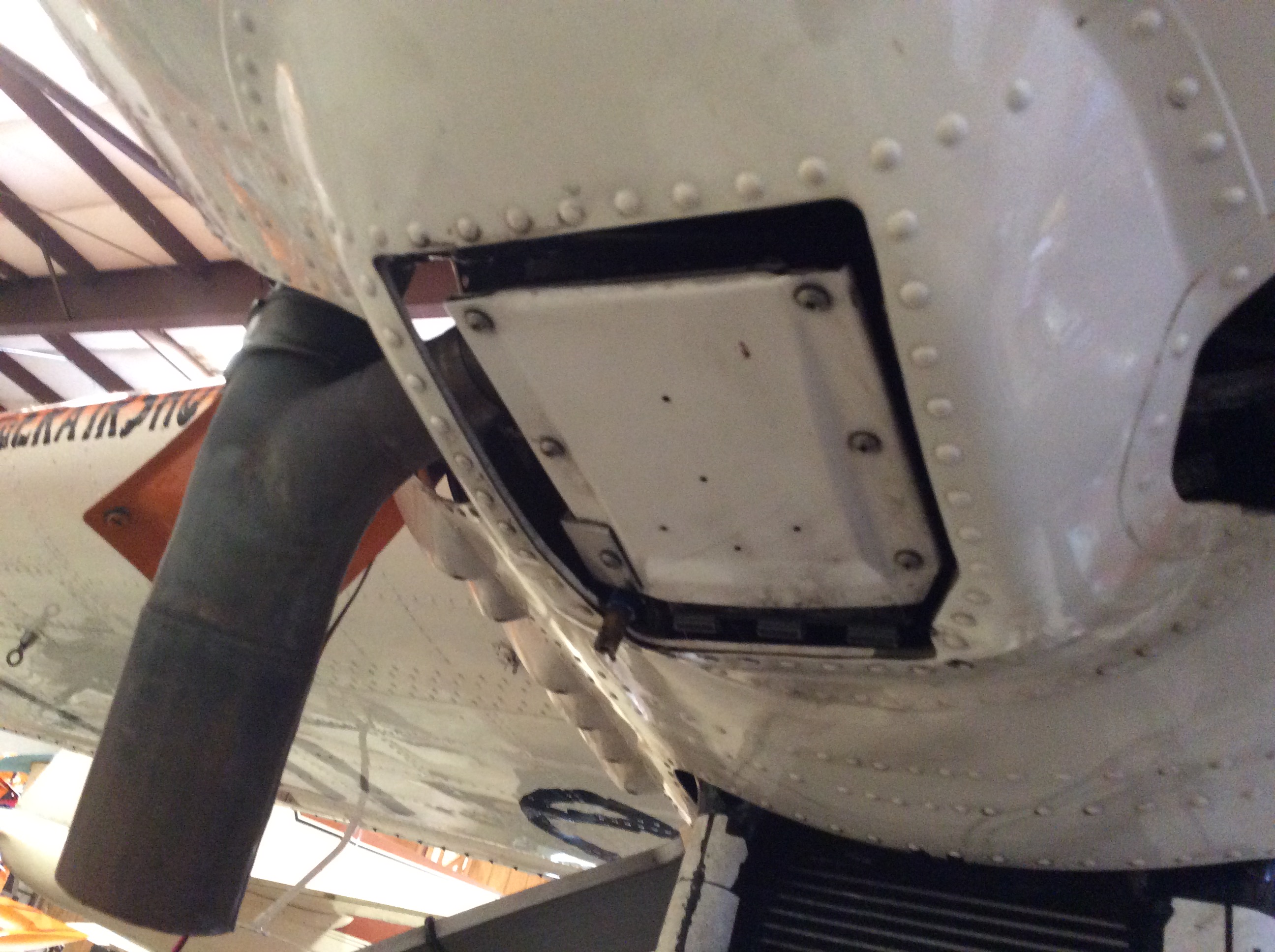

Yes. Very common in High humidity environments. Especially during cross country. Make sure your aircraft is configured for the condition of flight you plan to encounter.
Attached are photos fright from the Tech description manual of the Yak 55.
