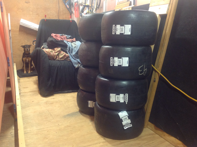

Search Nanco for some tires that are soft but for off-roading. I think someone assembles and sells sets using these tires. The smooth ones with no rib from the quads used on sand are the most popular, not sure they aren't 8" rims though. 6" I think can be had? Cheaper and you don't need those real wide ones on an airplane. Narrow profile is preferred.
Dennis Long
Oakland TN

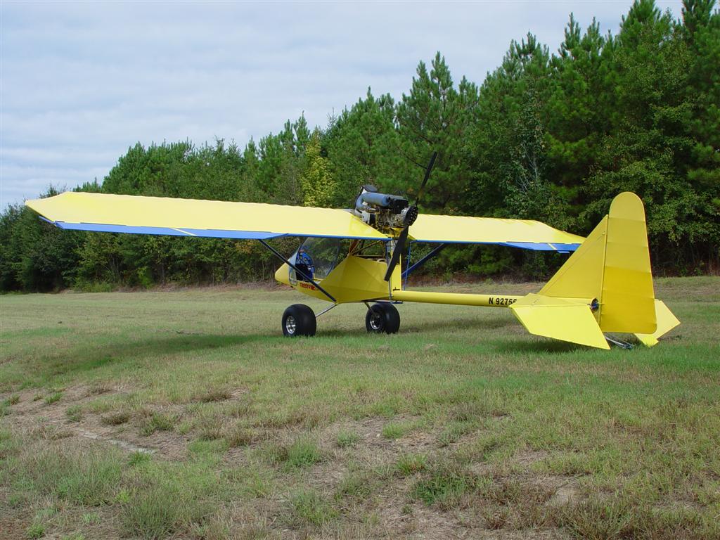

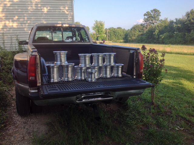

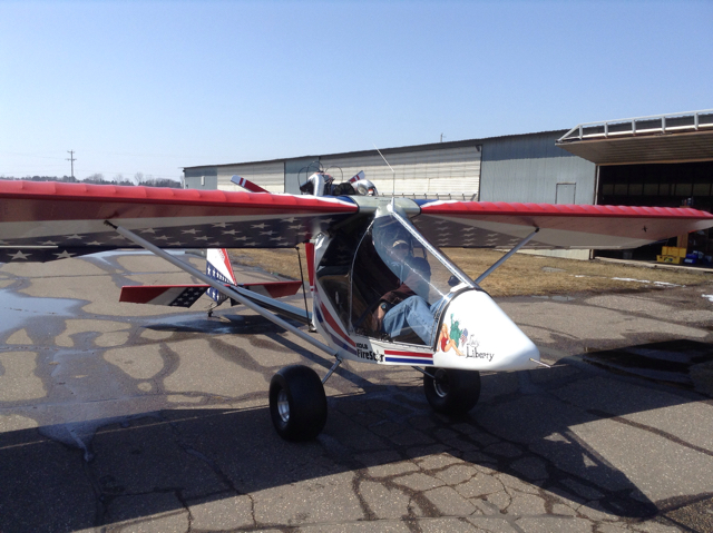

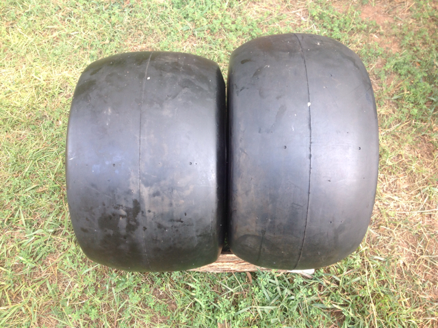

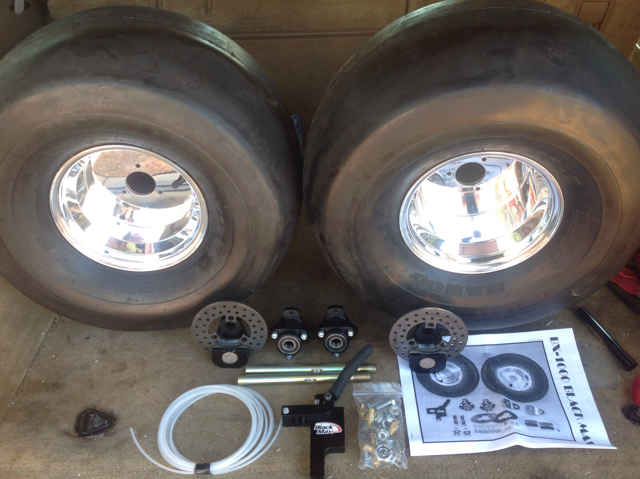

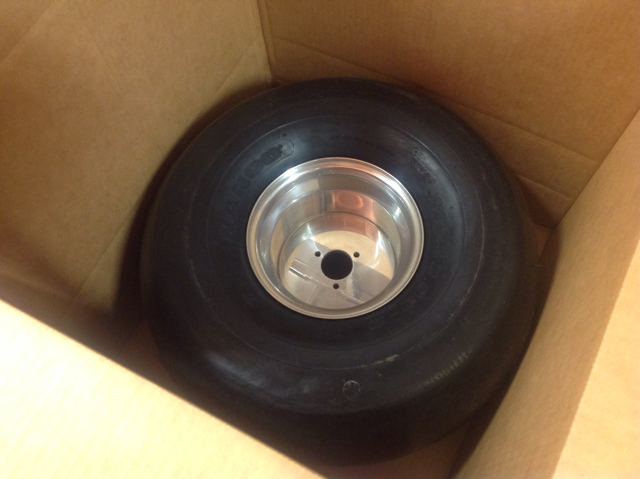

PostPosted: Sat Mar 12, 2016 9:45 pm    Post subject: Re: Tires for your Firestar Reply with quote
This is just my opinion but these are the best tires and wheel combination for a Firestar. HUGE 21" X 12" X 8" 2-PLY TIRES, 8" Diameter one piece Aluminum Wheels. Wheels 7"and 9" wide are in stock now . Custom sizes can be made. This is your one-stop source for Tundra/Bush Wheels, Tires, and Brake Systems. I have been supplying wheels and tires and brake systems to ultralights owners all the way up LSA owners. All the way up to 1500 lbs. 5/8" to beefy 3/4" axles. Either hand controls or heel & toe dual master cylinder configurations. I have single piston calipers and also dual piston calipers available. Whether you need Single items or complete systems we can make what you need.
Link to Bush tires and wheels video on YouTube
http://youtu.be/ysZBXy-pDzI
