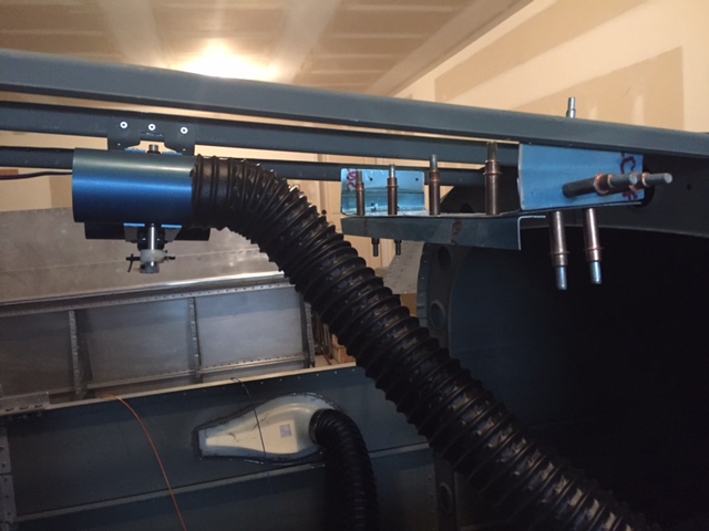

For those of you flying and have Aerosport's vent valve, is there ever an interference with magnetometer mounted in the area? I have fabricated bracket for my two Dynon magnetometers in most forward area of tailcone area (see picture) and was worried about its proximity to the vent valve. If there would be a problem would it just be when vent valve is activated (opened or closed)?
Matt

I have the same servo (it works great!). I mounted mine on the back of the brace that runs top to bottom behind the baggage compartment bulkhead. I haven't seen any issues with that location.
Cheers
Les

No issues here. I have the naca vent valve maybe 6 inches behind the baggage bulkhead right near the top skin, and the magnetometer on the top of the front side of the next bulkhead back.
