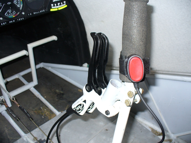

This is a picture of the two handle setup that I have.
Lee..

I used 2 brake handles on the control stick and I can activate either
side or both at the same time with just my fingers.
Thanks for your post and idea! I have been wondering if I should use
separate levers on my conversion. I have mtn bike disc brakes mounted, but
the caliper mounts are not done.
I was thinking about putting one brake lever on the left of the seat and
one on the stick. But as I read your post I visualized both on the stick,
maybe reversed so the handle ends are adjacent to each other. Dunno, maybe
it would work. How are yours mounted?

Using my mech brakes I came up with this and it worked very well. I found
it much easier to control my plane with these and using the rudders. They
at least were always positive, where as I find it difficult sometimes to
get my feet where I want them and use the rudders as well. Perhaps I am
just clumsy!
I had to do a bit of welding, but it worked just fine.
